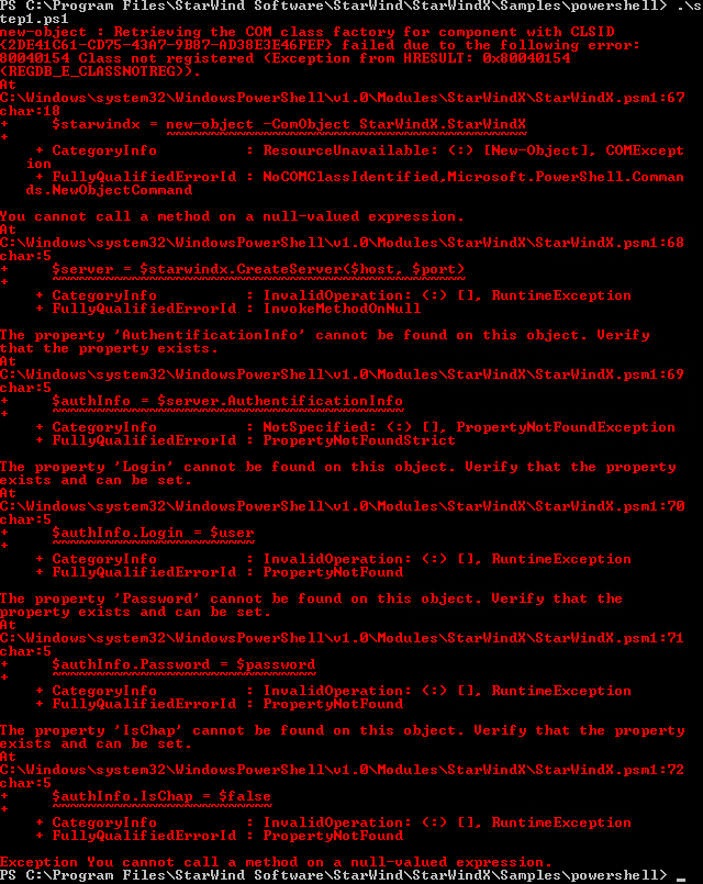

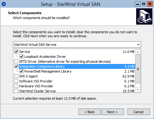

I have created a clean install of Hyper-V Server 2012 R2.
I have installed the Starwind vSAN Free, version 8.3.
I have installed the vSAN software with the options for the service, loopback driver, integration library and powershell management library (see attached file).
Install Options
Install Options

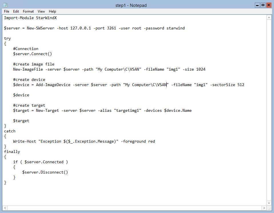

I modified the script to create the img1 file (see attached file).
Create Image Script
Create Image Script
I ran the script and got COM errors (see attached file).
COM errors
COM errors
Please advise.

Okay... here is what I've tried and confirmed.
I did a "fresh" install of Microsoft Windows Server 2012 R2 with the GUI.
I installed Starwind vSAN Free v.8.3 with only the Service, Loopback Driver, Integration and Powershell Management Library installed.
I copied the CreateImageFile.ps1 script to step1.ps1 and edited the file locations to be c:\VSAN
I ran the script... it worked.
I did a "fresh" install of Microsoft Windows Server 2012 R2 without the GUI
I ran the script... it failed.
The error references the CLSID as in the prior messages.
There seems to be a problem with the software working on the GUI-less OS.
Please advise/confirm ASAP.
Thank you.
