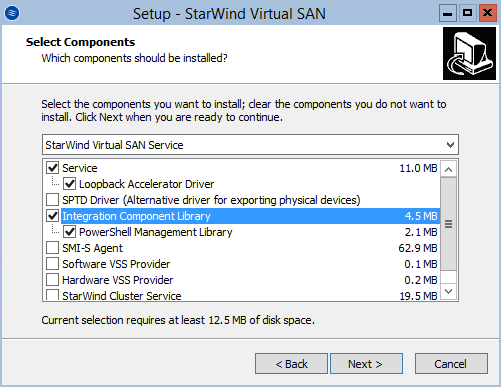

I have created a clean install of Hyper-V Server 2012 R2.
I have installed the Starwind vSAN Free, version 8.3.
I have installed the vSAN software with the options for the service, loopback driver, integration library and powershell management library (see attached file).
- Install Options
- starwind_install_options_1.png (23.02 KiB) Viewed 33146 times

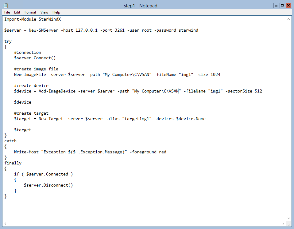

I modified the script to create the img1 file (see attached file).
- Create Image Script
- starwind_script_1.png (32.76 KiB) Viewed 33146 times

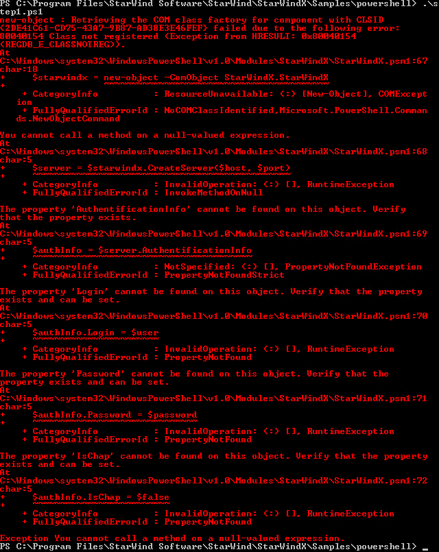

I ran the script and got COM errors (see attached file).
- COM errors
- starwind_error_1.png (89.84 KiB) Viewed 33146 times

Okay... here is what I've tried and confirmed.
I did a "fresh" install of Microsoft Windows Server 2012 R2 with the GUI.
I installed Starwind vSAN Free v.8.3 with only the Service, Loopback Driver, Integration and Powershell Management Library installed.
I copied the CreateImageFile.ps1 script to step1.ps1 and edited the file locations to be c:\VSAN
I ran the script... it worked.
I did a "fresh" install of Microsoft Windows Server 2012 R2 without the GUI
I ran the script... it failed.
The error references the CLSID as in the prior messages.
There seems to be a problem with the software working on the GUI-less OS.
Please advise/confirm ASAP.

Ivan (staff)
- Staff
- Posts: 172
- Joined: Thu Mar 09, 2017 6:30 pm
Fri Apr 14, 2017 4:51 pm
Hello tig_jeff,
Thanks for updating.
We have reproduced the issue in our lab and working on it.
I will update this thread as soon as an issue will be resolved.

Ivan (staff)
- Staff
- Posts: 172
Thu Apr 20, 2017 3:49 pm
Hello tig_jeff,
This issue will be resolved in the next build.
I will update this thread when next build will be available to download
