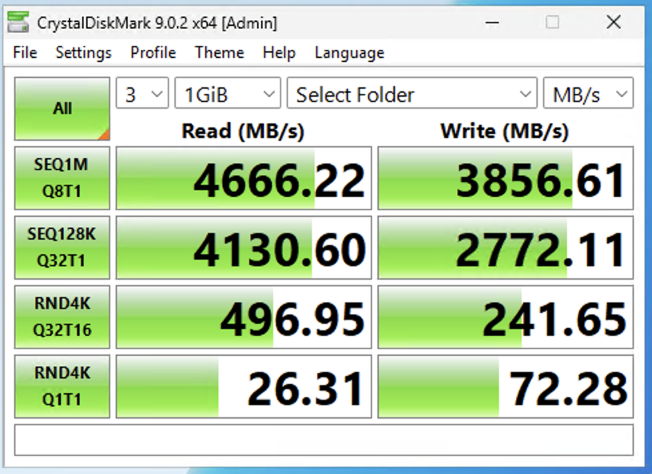

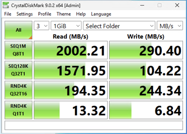

I was told to post this here on forum. I tried to deploy the StarWind VSAN Free for my client in the two node variant.
I have two Windows Server 2025 hosts that use very fast NVME SSD storage each. Each uses a mirror raid of multiple of these disks. Both nodes are directly connected without any switch with 2x25Gbs NICs. I have installed StarWind software directly on these servers and created a HA disk and connected it to itself as iSCSI disk that then I used to connect to the Failover Cluster (again on the same hosts) where I want to run VMs from this disk (even this was not exactly easy as the Knowledge Base is missing the manual how to do it for Windows Appliance, Hyper-V and Free non UI version...)
The website claims that there are no performance limitations of the free version. However, I’m dealing with a very poor performance of the disk. I’m attaching two screenshots. One is the performance of the single RAID disk on one of the hosts. The second is the performance of the StarWind CSV disk. When running, I see the network cards barely utilized. Yes, I was told the CrystalDiskMark is not optimal, but still. The performance it shows is abysmal and I had to remove all VMs from such disk as the users complained of the poor performance.

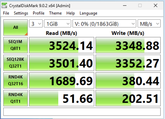

- I have a single disk performance from previous tests:
9 single disk cache.png (220.8 KiB) Viewed 22415 times

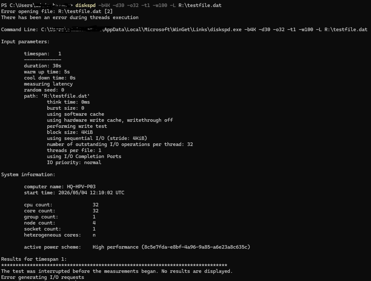

I tried to connect the device via the loopback session and now I have a disk mounted on one server (and starwind I presume syncs it to the other).
I have trouble running the test using the tool you wanted:
error Large copy.jpeg (135.2 KiB) Viewed 20845 times

That's not quite how it works.
Yes, VSAN will sync data to the replication partner. But shared storage must be connected from all replication partners; only then will client VMs benefit from shared storage.
What you can do is connect the volume over multiple iSCSI sessions and set them active through iSCSI Initiator and MPIO policy called Round robin with the subset.
Try tuning the tool. It looks like the settings are wrong; furthermore, a single thread is not enough to saturate the target performance.
