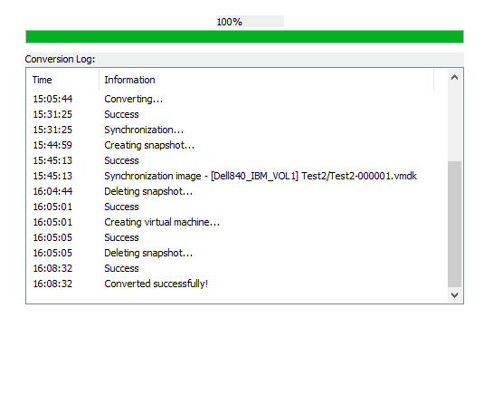

I did live migration of VM from ESXI to HYPERV its showing successfully converted. When i open VM in Hyper-V that disk is not attached to VM, while attaching disk to VM showing an error that "Error applying disk change" and disk is corrupted and unreadable

Note: 1) In my scenario live migration of windows vm from esxi to hyper v successfully completed converting i am attaching screenschot
2) I did not uninstall VMware tool
Mon Nov 25, 2024 1:03 pm
There is a link in that thread.
First of all, please try removing the VMware tools. This is might be what is clashing with conversion.

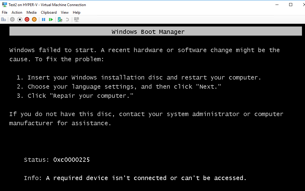

I have used v2v older version successfully converted machine to Hyper-V. When i powered on the VM getting error. I am attaching the screenshot
windows error.PNG (28.03 KiB) Viewed 55018 times
Mon Nov 25, 2024 3:07 pm
The issue seems to be related to the residual drivers from the source environment as the converter ran without errors.
Please try removing the VMware tools. This might be what is clashing with conversion.
Please also try booting the VM with the IDE controller attached.
Check also this out https://www.erniecosta.com/2020/02/26/h ... t-drivers/.

Okay I will remove vmware tool and VM is gen2 so it can't run on IDE controller.
I have one question that EXSI server and hyper v server both are from different family. Because of this VM is not booting??
Tue Nov 26, 2024 5:05 am
Try converting individual disks and resemble the VM afterward as Gen1.
