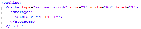

5. Locate the sections as in Screenshot1:
Screenshot1
Screenshot1
6. Comment it out to have it as in Screenshot2:
Screenshot2
Screenshot2
7. Locate the following section (Screenshot3) in the same file and comment it out:
Screenshot3
Screenshot3
8. Start the StarWind service. At this point, the service will pick up the device with no SSD caching.

12. Uncomment config sections from steps 5-7 and adjust size and path to current SSD cache disk (parameter "size" for snippet from Screenshot 1, and parameters "name" and "size" for the snippet from Screenshot3).
