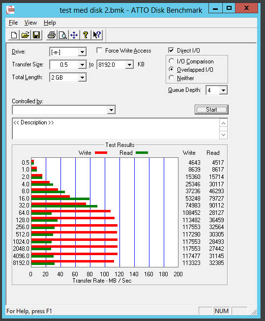

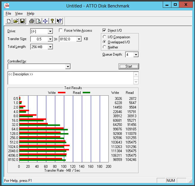

Tue Aug 20, 2013 3:40 pm
I use ATTO.
I have attached 2 screenshots.
This is using MS iSCSI in a VM
This is direct ESX
This is direct ESX
Tue Aug 20, 2013 4:23 pm
It's definitely something related to the packet size as sub-64KB reads are fine. Let us take a closer look @ the issue...
