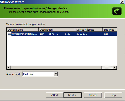

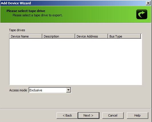

When I run the Add device wizard, and select Export tape auto-loader/changer device, I can select the auto-loader but in the next step, there is no device in the select tape drive windows. I can see both the drive and the library in device manager and I have tested the library using Veeam with success. Tape redirector was installed on a VM running Windows 2012 R2 and I have also tried using a windows 2008 R2 with the same problem. What am I missing?

Choosing tape drive.  Empty list.
tape drive selection.png (56.54 KiB) Viewed 105877 times

Here is the other print screen showing the library in the Add device wizard. As you can see, I can select the library but there are no tape drive to choose from. But both the tape drive and the library are present in device manager.
Library selection.
Library selection.
library selection.png (80.94 KiB) Viewed 105877 times

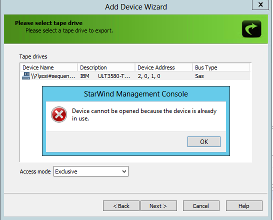

In StarWind management console add one target, and then using the right-click option "Add new device to target" add your two devices. thus you will attach two devices to one target. Let me know if it did not work.
pmsadmin
Joined: Wed Aug 13, 2014 5:01 pm
Thu Aug 21, 2014 3:41 pm
It does not work. Getting this error.
Wed Aug 27, 2014 7:40 pm
Hmmm... Looks weird.
