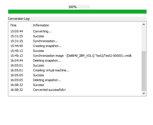

Note: 1) In my scenario live migration of windows vm from esxi to hyper v successfully completed converting i am attaching screenschot
2) I did not uninstall VMware tool
- starwind.PNG (12.69 KiB) Viewed 55049 times

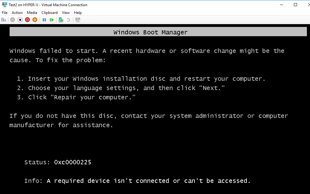

Hi ,
I have used v2v older version successfully converted machine to Hyper-V. When i powered on the VM getting error. I am attaching the screenshot
- windows error.PNG (28.03 KiB) Viewed 55005 times

Okay I will remove vmware tool and VM is gen2 so it can't run on IDE controller.
I have one question that EXSI server and hyper v server both are from different family. Because of this VM is not booting??

When i migrating VM of bios mode from VMware to Hyper-v ,i am getting error snap is attached for reference
Mohammad
- BIOS error.PNG (27.41 KiB) Viewed 54027 times
