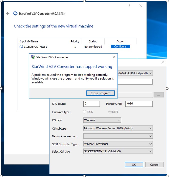

Sto provando ad utilizzare il prodotto StarWind per spostare delle VM native di un tenant ferso un altro tenant dentro una soluzione AVS.
Dopo aver creato nel source un Application ID/Secret e aver indicato come target il vCenter AVS utilizzando l'utenza "cloudadmin" messa a disposizione da Azure , quando scelgo l'host ESX il prodotto va in crash.
Ho installato StarWind dentro un jumbox azure nella network JumphostSubnet in modo tale che potesse comunicare con gli ESX.
Cosa manca in crash Starwind ?

This is the Event View recorded at the time of the crash.
Faulting application name: V2V_Converter.exe, version: 9.0.1.848, time stamp: 0x692454f3
Faulting module name: V2V_Converter.exe, version: 9.0.1.848, time stamp: 0x692454f3
Exception code: 0xc0000005
Fault offset: 0x000000000003b78e
Faulting process id: 0x1940
Faulting application start time: 0x01dcf7f8179ef6a0
Faulting application path: C:\Program Files\StarWind Software\StarWind V2V Converter\V2V_Converter.exe
Faulting module path: C:\Program Files\StarWind Software\StarWind V2V Converter\V2V_Converter.exe
Report Id: d6bac31d-57c6-41ad-bf63-62156cd75c0f
Faulting package full name:
Faulting package-relative application ID:

THZ for the new version, but unfortunately, the error is the same with the new version; I am attaching the event view.
Exception code: 0xc0000005 ( Access Violation)
Faulting application name: V2V_Converter.exe, version: 9.0.1.850, time stamp: 0x69809cd5
Faulting module name: V2V_Converter.exe, version: 9.0.1.850, time stamp: 0x69809cd5
Faulting process id: 0x19d0
Faulting application start time: 0x01dcf7f9957f84fb
Report Id: 5252d412-52b7-4fe1-ba2a-f14a83a5b12d

Tue Jun 09, 2026 5:37 pm
I am trying to migrate native Azure VMs from Tenant A to Tenant B. In Tenant B, the target environment is an Azure VMware Solution (AVS) cluster with vSAN storage.
As a troubleshooting step, I also tested a different destination environment: an on-premises VMware infrastructure running vSphere/ESXi 6.7.
However, StarWind crashes at exactly the same point in both scenarios: when I select the destination ESXi host.
This suggests that the issue is not specific to AVS, vSAN, or the target environment itself, since the same behavior occurs against a completely different VMware platform.
Source:
Microsoft Azure native Virtual Machine on "tenantA"
Operating System: Windows Server 2019
VM Generation: Gen2 (UEFI/GPT)
Source hypervisor: Microsoft Hyper-V (Azure platform)
-Destination1:
CLOUD AZURE DIFFERENT TENANT "tenantB"
VMware vSphere environment hosted in Azure
vSphere Client version 8.0.3.00500
VMware ESXi, 8.0.3, 24797835
Storage vSAN
OR:
-Destination2:
ONPREM site
VMWare 6.7
vSphere Client version 6.7.0.53000
VMware ESXi, 6.7.0, 24514018
Starwind crash on the same point when select the ESX destination
