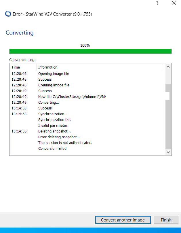

However since today I am facing a new challenge.
Upon searching i found about session timeout setting in vmware (which i did not face before during live migration) to disable.
But even after the change the live migration is still failing.
Also tried updating to latest version but did not help.
Is there something I am missing?
Screenshot 2025-06-09 131510.png (30.92 KiB) Viewed 26488 times
Posts: 4432
Mon Jun 09, 2025 10:25 pm
There's a known issue with live conversions. You might need to shut down the VM or try P2V conversion.
