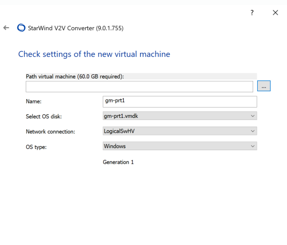

i would like to try the software but i'm facing issue during configuration.
I'm able to select source vm from center and then connect to Hyper-V cluster but next step virtual path is empty and nothing happen when i click on the three dots.
I using the last version 9.0.1.755 but i have the same result with 9.0.1.268.
What could be the problem?
Thank you

Welcome to StarWind Forum. Please, tell me more.
Namely, where you run the converter and try a different machine (e.g., try running it locally as an administrator).

Try uninstalling and reinstalling to see if the error is fixed

I tried but no luck
path stays empty
Namely, where do you run the converter? What are the ESXi and Hyper-V versions in use?
Try a different machine (e.g., try running it locally as an administrator).
Please see this comment. To file an internal request I need more info

Thank you, i solved this issue by reinstalling on another server.

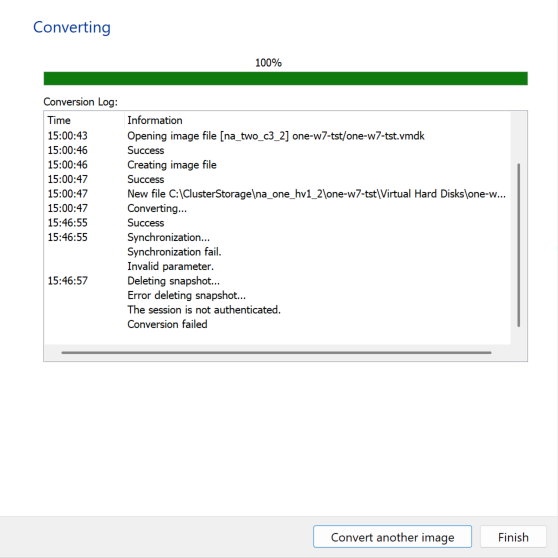

Now, i'm facing this error:
any idea?
I will try without sync.

It looks like a known issue with snapshot removal.
Try shutting down the VM and converting it.

Thank you.
It worked.
