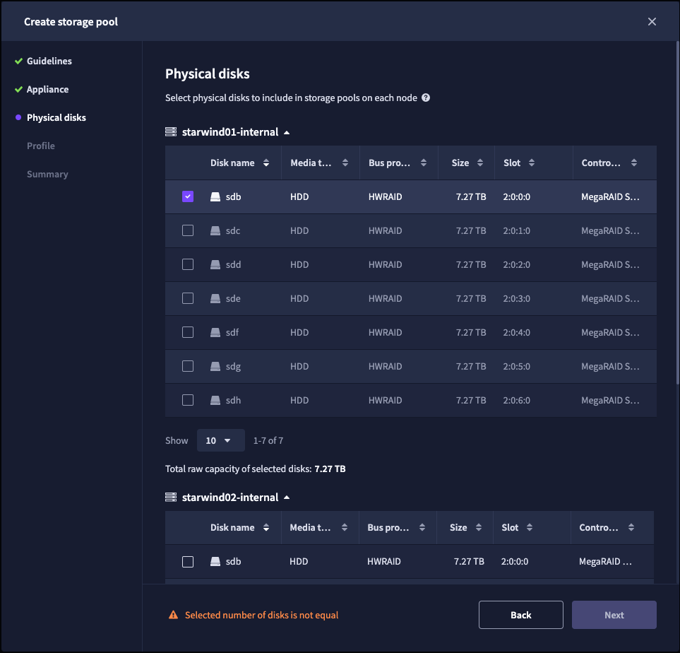

Hi there, I am very new to Starwind VSAN so please forgive my ignorance especially if this is an easy question. I am trying to create a storage pool on my two node cluster but am having issues adding more than 1 drive per host. My setup is ESXI managed via vSphere with raid controller on each host passed through to the VM on each host.

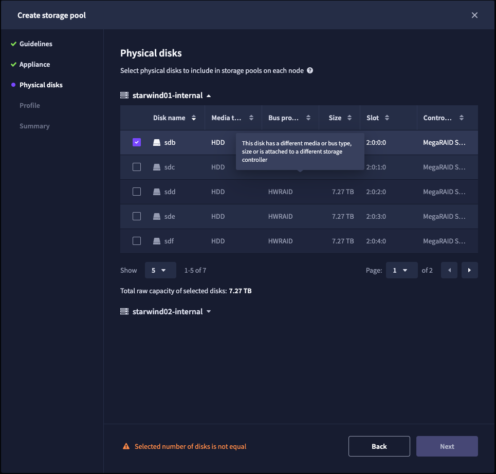

I can see all the drives appear in the web interface but cannot seem to add more than 1 drive from each for the life of me. The particular error I am getting is "This disk has a different media or bus type, size or is attached to a different storage controller" I tried looking through documentation as well as the forum but could not see anything regarding this. All of the disks on each host are connected to the corresponding raid controller on each host and they are all the same size and model of drive so I know there is no difference there.
Screenshot 2024-08-27 at 8.07.39 PM.png (110.69 KiB) Viewed 42382 times
Screenshot 2024-08-27 at 8.07.51 PM.png (108.71 KiB) Viewed 42382 times

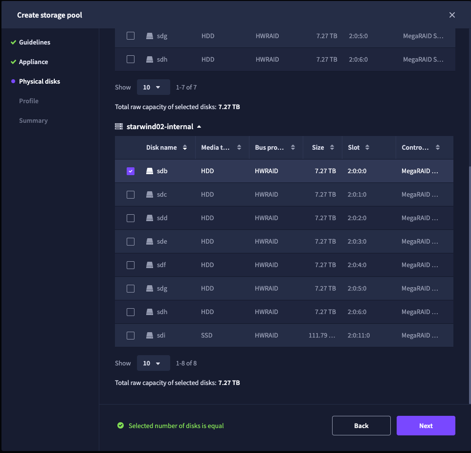

Screenshot 2024-08-27 at 8.09.51 PM.png (104.46 KiB) Viewed 42382 times

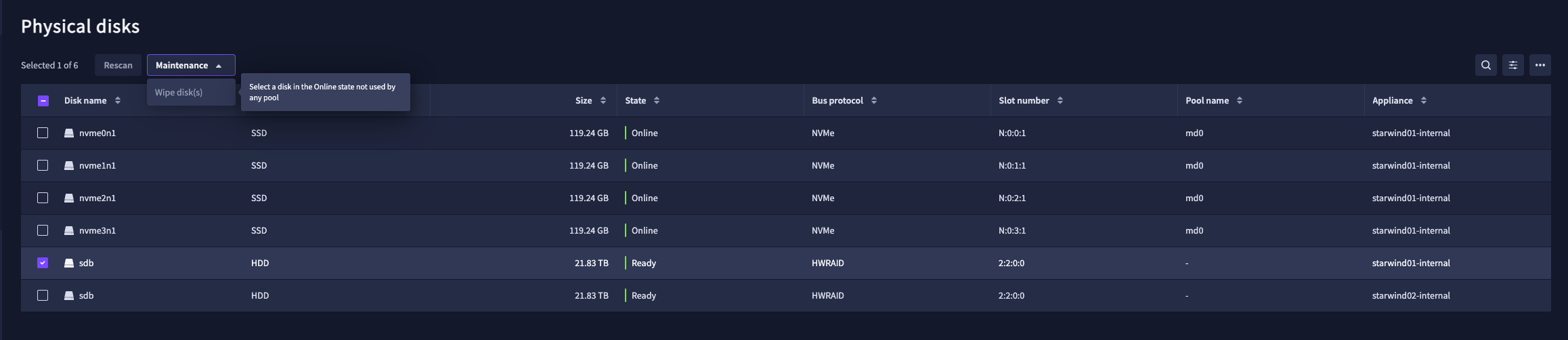

I am unable to wipe the disks though the UI, see screenshot below as well as logs here https://drive.google.com/drive/folders/ ... sp=sharing.
Screenshot 2024-09-03 at 4.53.26 PM.png (67.65 KiB) Viewed 41293 times
