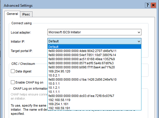

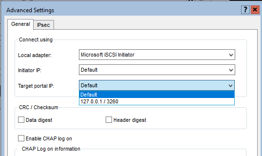

OK, and how can I troubleshoot this case?
One of the nodes have big CPU load, when I work with StarWind disk. I suspect, that your loopback accelerator does not works properly on that node.
On "good" nodes, when I add connection, I have a list of ip addresses:
and on "poor" node only 127.0.0.1
What should I do?
How can I check that the accelerator driver working properly?
Do you have any registry keys, files etc. to check?
Could your advanced support staff help me?
Yury
Posts: 4508
Tue Oct 05, 2021 4:57 am
Please provide me with a screenshot of the discovery tab. This can be an MS iSCSI Initiator GUI glitch.

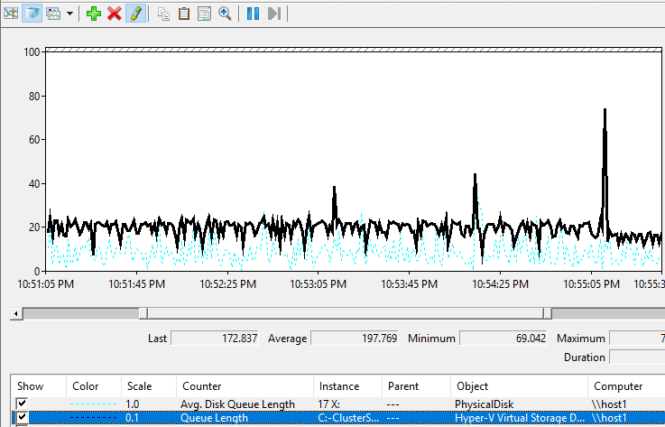

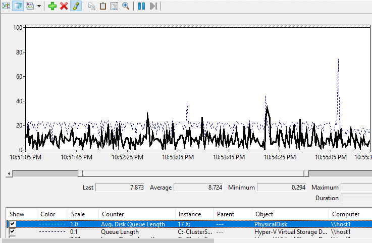

Below are results for disk queue inside vm and underlying storage
As you can see, the disk queue inside of vm is about 197 and at the same time, disk queue for underlying storage is about 9. So, I think that StarWind is a bottleneck.

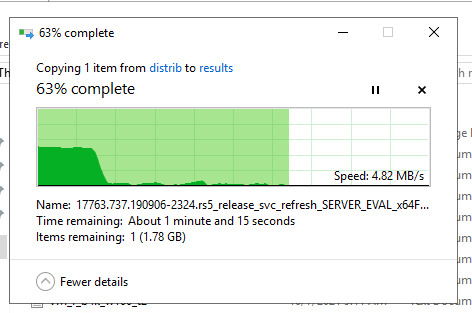

When I try to copy a file inside of my VM I get following results:
If I use 127.0.0.1 address the results are more pretty and average throughput is about 150 MB/s

Finally, file copy is not a reliable test: Windows Server has SMB transfer speed https://docs.microsoft.com/en-us/window ... e-transfer. What you can do is using xcopy as MS suggest, or tweaking these small things
