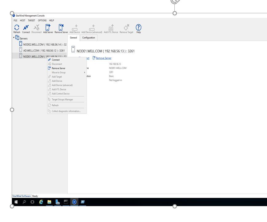

I'm also having same issue , disk options are greyed out. Could you pls help.
Posts: 4510
Mon Mar 29, 2021 7:41 am
Welcome to StarWind Forum. Having a screenshot will be much appreciated.
You can try creating the HA device with the script at C:\Program Files\StarWind Software\StarWind\StarWindX\Samples\powershell as described here https://forums.starwindsoftware.com/vie ... p+3#p31505.

The server that you have selected is disconnected. Double-click to connect and try again, or try selecting the blue server above.

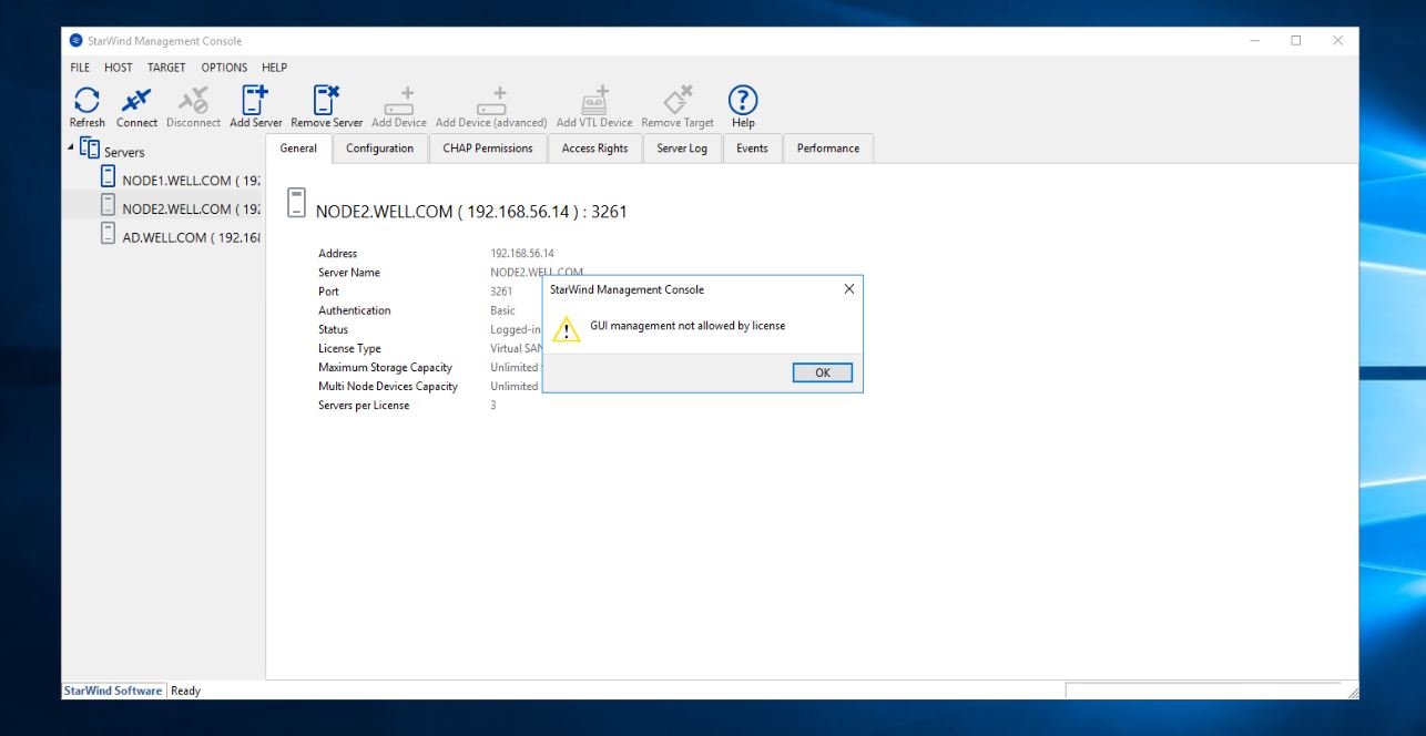

Mon Mar 29, 2021 8:10 pm
Thanks, I have tried again. Please find the attachment.
Posts: 4510
Tue Mar 30, 2021 7:24 am
That's because of free license that you have. You need trial, NFR or Commercial license to access the GUI.
Press OK. In Free bersion GUI is for monitoring only. You can create the HA device with the scipt as I mentioned it earlier.
