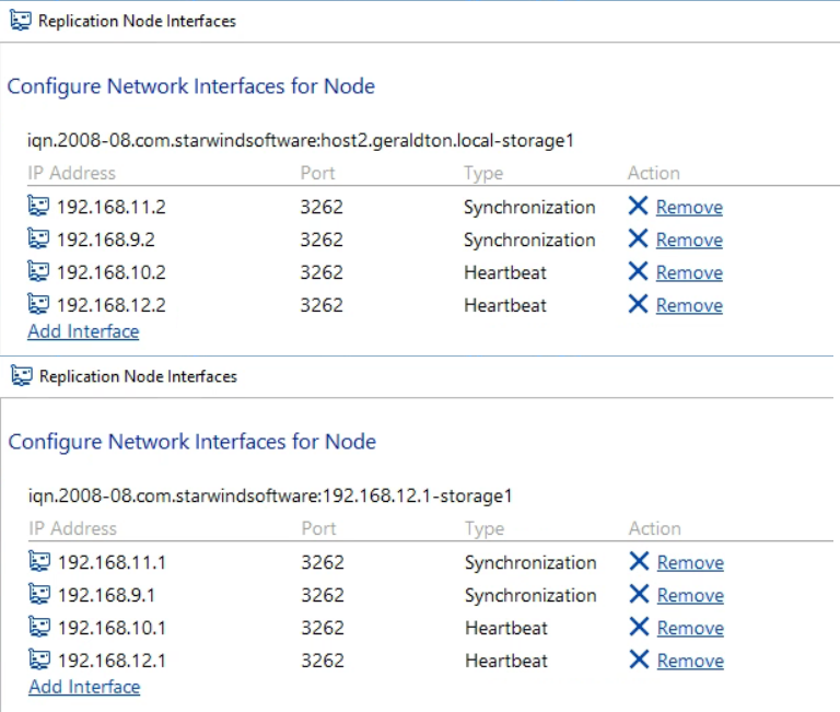

Do you have a network diagram? It will be much appreciated. Looks like the IP addresses you are trying to use for iSCSI connections are not available.

Here are the current network interfaces.
I can create a new drive and add a replication partner. Its only when I try to add the third replication partner.
