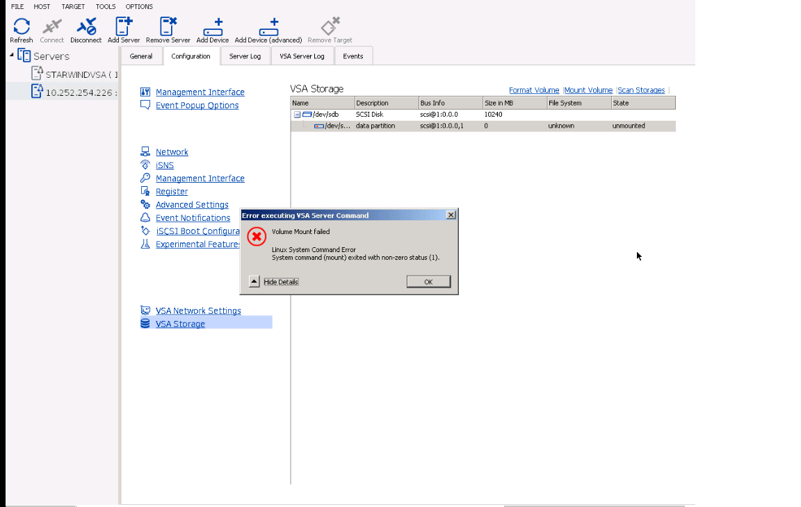

Brand new to Starwind here and am trying out the HyperV VSA, I have been following along the guide V1.0 Jan 2017 and am stuck a t step 23 creating a volume, I have tried this on 2 nodes with same result, after selecting "create volume" an error message is returned. Volume Mount Failed. Linux system command error. Its probably a school boy error on my part.... any assistance gratefully receivd
Cheers
John

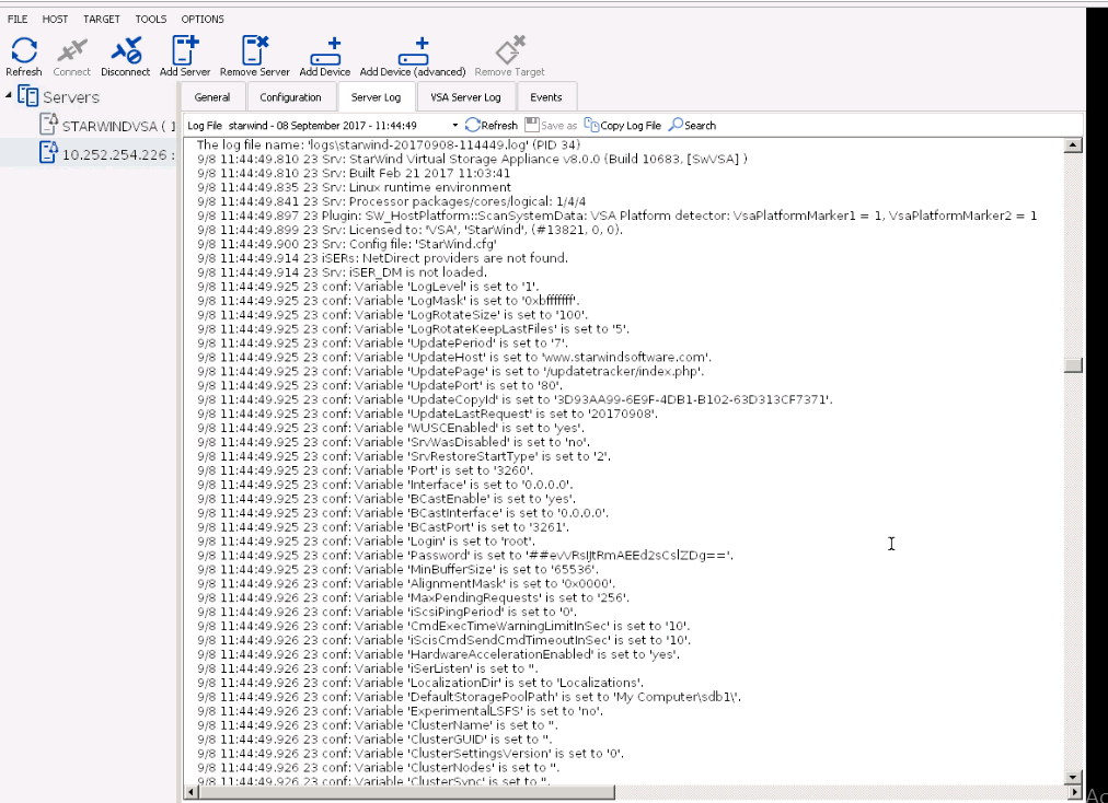

Some more screenshots
I have tried to copy the text or save the log file but the browser " chrome " does not seem to allow this functionality
log error.png (231.59 KiB) Viewed 32248 times

I also have this issue. Did we get anywhere on this?
I'm using Hyper-V on Windows 10 Enterprise. I shall also try this on Server 2016 with Hyper-V role too and post back.
But, Windows 10 has the same error as the original post.

Hey folks,
I've also tried this with Windows Server 2016 running the Hyper-V role - same issue.
'Volume Mount failed - Linux System Command Error. System command (mount) exited with non-zero status (1).
Any ideas?

The VSA storage screen does show File System - Unknown.

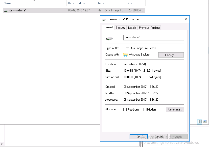

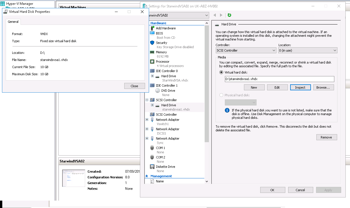

Figured it out. Using VHDX with Fixed Size fails.
Using VHD with Fixed Size is success.
Following this documentation says to use VHDX, however, doesn't work for me.
https://www.starwindsoftware.com/techni ... yper-V.pdf
Should VHDX work here? Or is it me?

Hello guys! Yes, the .vhd drive created instead of .vhdx, solves the issue. You can login with IP, instead of VM name in order to prevent any conflicts. You can assign a static IP address under Configuration tab --> VSA Networking Settings.
