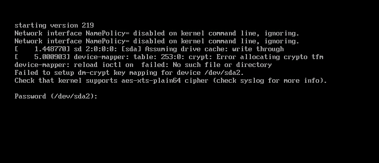

Just installed the VSA for VMware. It starts to boot and comes to a screen asking for a password. Password (/dev/sda2):

I did delete the VM and downloaded the OVF again and re-installed. Same issue. Does your OVF require ESXi 6.0? I am trying this on 5.5u3. I have the VM compatibility set to hardware level 10. I did try the OVF in VMware Workstation 12.5 and it works fine there. I may try to export it from Workstation to ESXi and see if that works.

I am having the exact same issue. I have tried rebooting and even downloading the virtual appliance again. I am trying in a ESXi 6.5 host. I also have the same issue with Workstation 12.5. If anyone at Starwind is monitoring this forum please provide some information.

So what I figured out is that error is causing by a processor issue. There are older Xeon procs that don't contain the instruction set for that type of encryption. I vmotioned the VM to a new host and it will boot now. The problem I have now is I cannot get the zoom to go down in the web page or the console. It is stuck on 162% and I cannot see the whole screen. I gave the VM more video RAM, which I should not have to do and the problem got only slightly better.
Happens in all browsers.
So a try a different processor type on another host and see if it works...
I tried workstation 12.5 and that worked. But it was a newer gen Core i7 proc.

The proc type that did not work was a Xeon X7460. The proc type that did work is a Xeon X5650.

I am using a Xeon L5640 and it is not working for me.

tohoken wrote:I am using a Xeon L5640 and it is not working for me.
What version of VMware? What VM hardware version? You get the same error that I was getting?
tohoken
Posts: 9
Joined: Mon May 01, 2017 5:29 pm
Tue May 02, 2017 6:39 pm
Yes, I get the exact same error that you posted. Using ESXi 6.5. I am not changing any settings so the hardware version is what comes from the ovf.

tohoken wrote:Yes, I get the exact same error that you posted. Using ESXi 6.5. I am not changing any settings so the hardware version is what comes from the ovf.
Well when I installed it, it was hardware version 8. You should be on version 11 at least with 6.5. Do you have VMware EVC mode enabled on the host?

tohoken wrote:This is a single esxi host, no clusters so no EVC. I have no idea how to fix this.
It could be the L series processor. What type of machine is the host? My L series proc wont run it.
