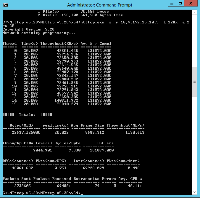

When using iperf I can get 8.79Gbit/sec across the link. However when Starwind is performing a fully sync it will get to 1Gbit (around 115MB/sec we see written) and never go above that. It's almost as if its hitting some sort of limit?

Did you play with S/W sync priority set? What latency do you get with your connections? Any chance to see also NTtcp numbers?

Yes, I've moved the slider all the way to the left (Faster Sync). The latency between hosts is <1ms using ping test over an extended period. Please see attached screenshots of ntttcp test (was able to get 1130 MB/sec). We are syncing a flat image file and no load on server during sync. What strikes me as odd is that it can hit 1Gbps no problem and pins it there. If it was dipping/rising or was lower then I'd suspect disk, but because it always goes to exactly 1Gbps led me to believe that something was throttling it.
screenshot of ntttcp test between hosts

±50% CPU usage is annoying... Also IPoIB is not fast. OK, I'll ask guys to do a remote session with you to see what's wrong with your config.
