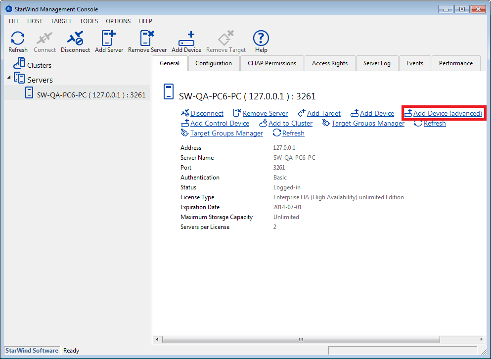

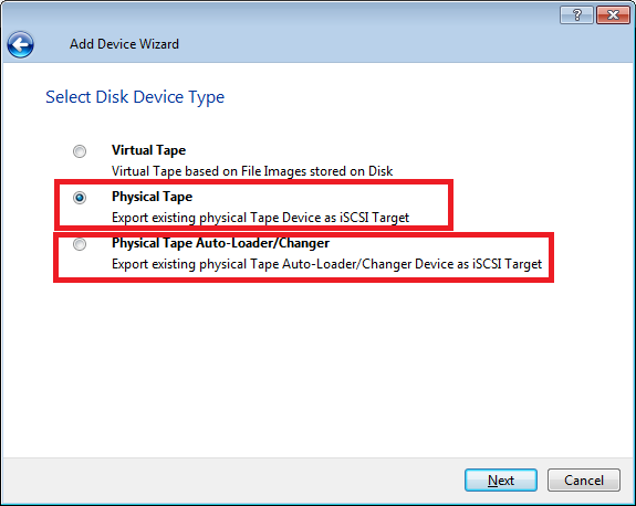

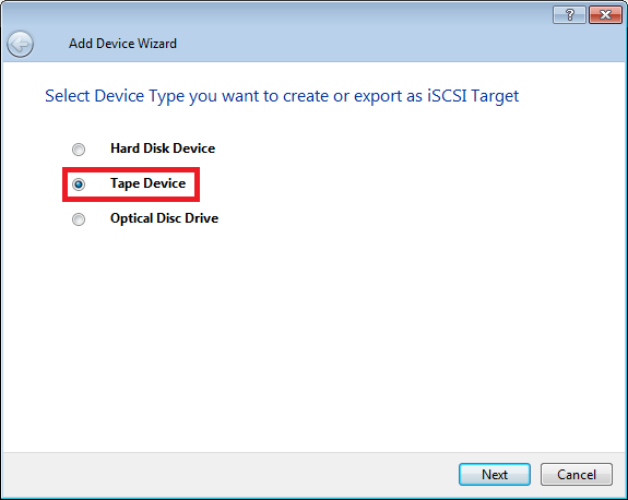

Three steps to add the device:

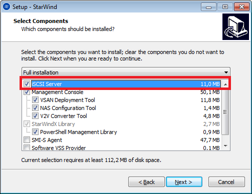

Very thankfull for your quick replies, see that you do have a server to configure. SW-QA-PC6-PC on your localhost machine. After my installation there is no server / service running.
I can add a localhost but cannot connect as it tells me that the Starwind service is not found.
Just installed the Starwind-v8.exe
Full installation minus Software and Hardware VSS Provide
But it seems that I have to install more than only those components.
Tue Jun 03, 2014 3:25 pm
You install StarWind Service on your machine with a tape drive attached and connect to it from the other machine running Management Console.

thuizt
Joined: Mon Jun 02, 2014 1:53 pm
Tue Jun 03, 2014 3:59 pm
Hello Anton,
I'm probably a very dumb person but what do I do to install the "Starwind service" ?
Where does the setup package come from ???
Do I have to install the Virtual San again and will it install the service ??
Currently installed the Virtual San software on the machine with the tape attached. No service available though.
Thanks.

Wed Jun 04, 2014 9:42 am
This is our problem and not yours :( If you run unsupported version of OS (Windows Server 2003 or Windows XP) you're not going to see "Service" in the list of available options. Please confirm what you have and we'll figure out how to tell to customer "this option is N/A" instead of just hiding it. Thank you!
