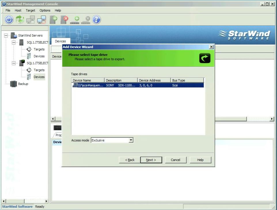

exporting tape drive
export tape drive - drive within changer is listed and exports.

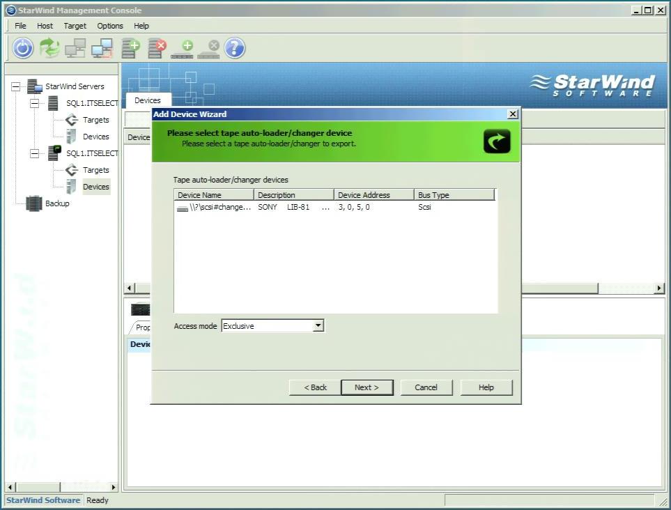

exporting autoloader
export autoloader - changer is listed

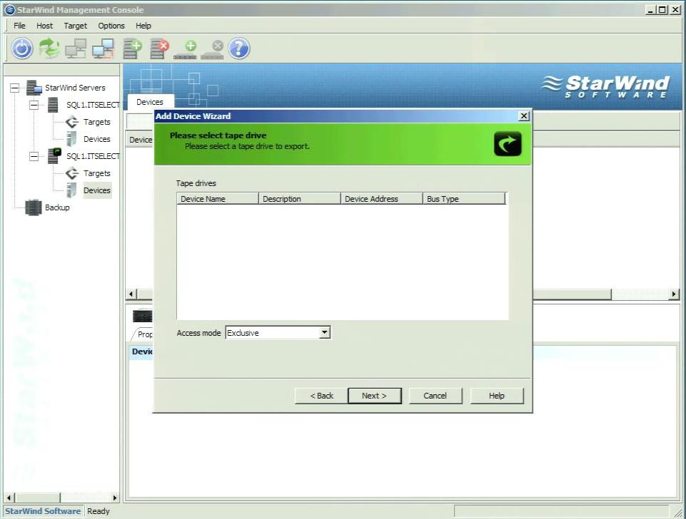

click next, and drive within the changer is not listed.
