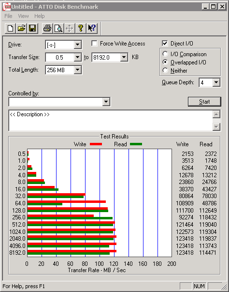

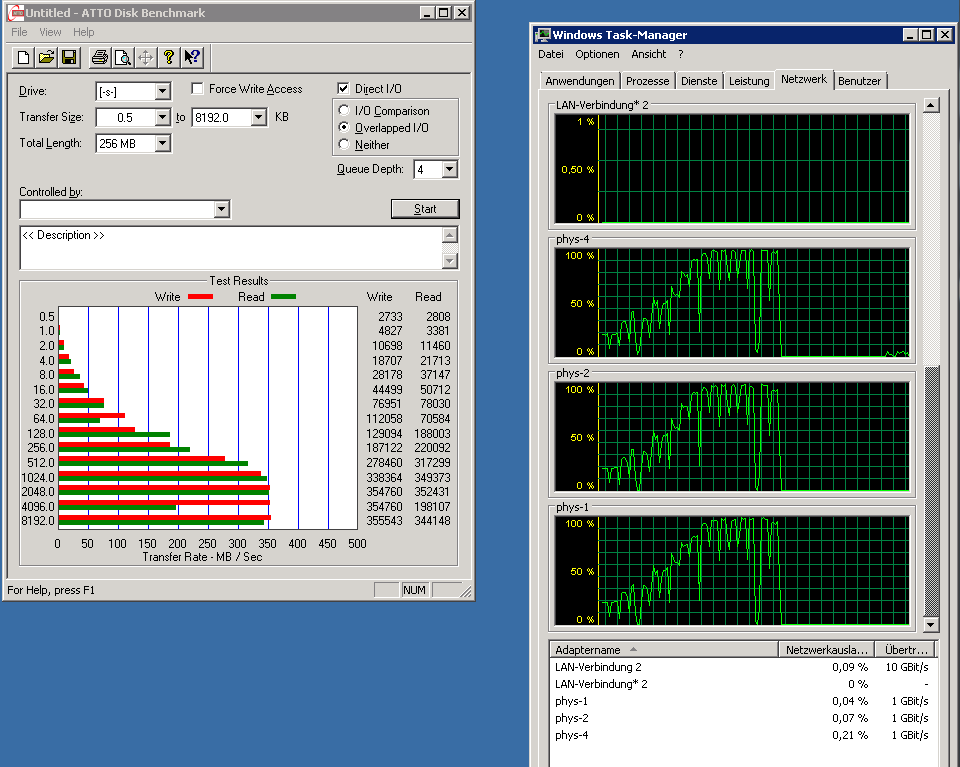

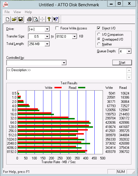

I thoroughly followed the Starwind MPIO pdf guide. Nevertheless, the atto benchmark results attached to this (acquired directly on the client) are far from the results measured directly on the server. In particular for small transfers sizes, performance is only about 10% of the native server results.

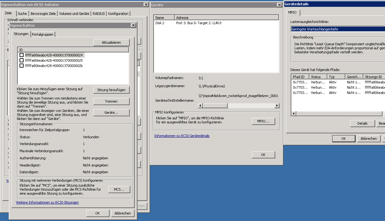

Could you please show how the 3 pathes are displayed in the iSCSI initiator device properties?

Please find attached some screenshots of the iscsi initiator.
Please note: Although currently configured as "least queue depth", we tried "round robin" also. It showed a bit lower performance results compared to the first.
I do not think anymore that the issue is related to the MPIO config. If I disable two of my three NIC connections in the ISCSI Initiator, the results for large transfer sizes remains limited due to 1-Gbps network; however, the smaller transfer sizes are still the same kind of weird slow.
(see attached screenshot).

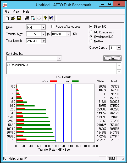

Also, I did a localhost iSCSI connection. I am not sure, if this is a valuable test - anyway, the results are good in this case, i.e. for small transfer sizes 5 to 10 times faster (see attached).

Yes, I get the same results with jumbo frames turned off. To be clear: I used a cross-over lan cable to bypass the cisco swith, and disabled jumbo on both NICs - no performance increase.

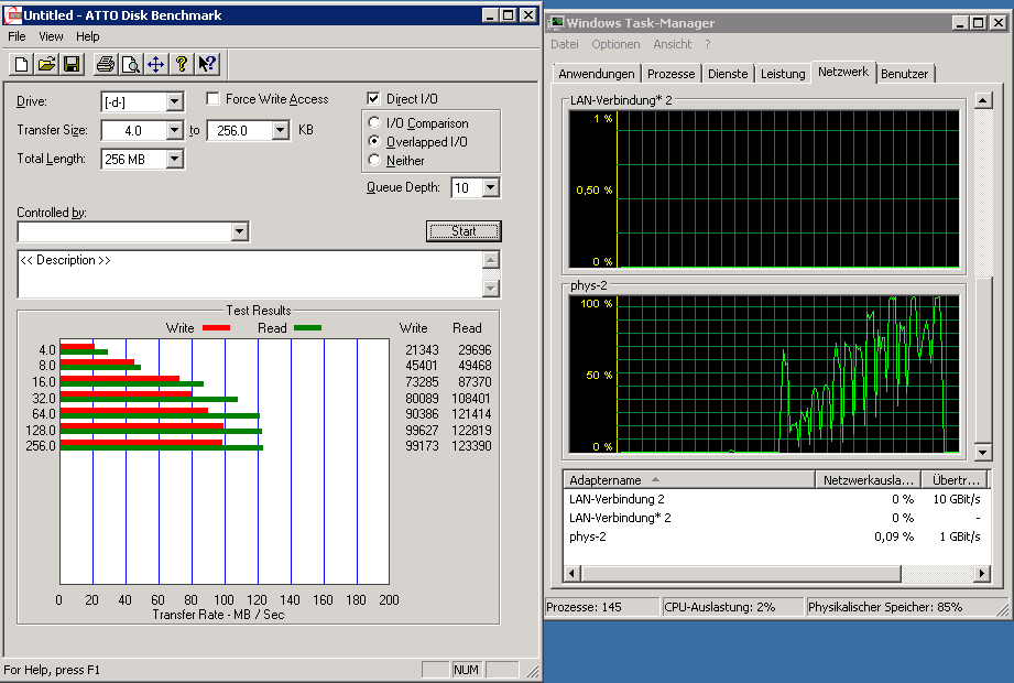

atto depth 10 write back cache 512 mb
atto depth 10 - mpio -write-back.PNG (62.11 KiB) Viewed 39730 times

Posts: 533
Thu Apr 04, 2013 11:44 am
Matthias,
The last test looks like using 3 connections, could you please exclude MPIO from the equation to check if a single link is getting saturated in these tests.
also, could you please test the link itself following the guidelines from this document (ntttcp/iperf)
http://www.starwindsoftware.com/starwin ... ice-manual

Matthias
Posts: 14
Joined: Tue Apr 02, 2013 1:38 pm
Thu Apr 04, 2013 1:53 pm
Max,
Thank you for coming back.
I disabled MPIO, and did some benchmarks with just one NIC (see attached). Small transfer sizes remain very slow.
As I stated earlier, I tried a different client (my workstation) with no MPIO, and low performance on small sizes.

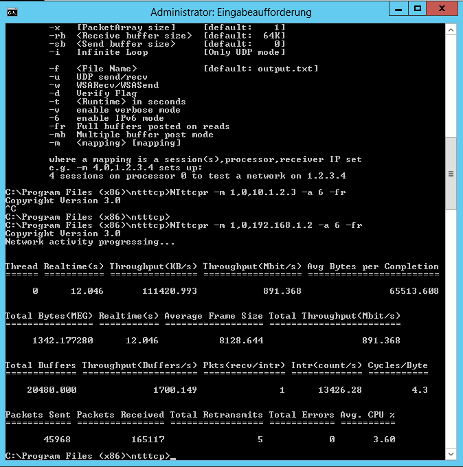

I used ntttcp to check the link, 890 MBit throughput, and 8128 average frame size - looks good (see attached). Currently, and for me it seems that either the combination of StarWind / W2k12 or some other server relevant circumstance causes the issue (bad server NICs)...

Max (staff)
Posts: 533
Thu Apr 04, 2013 2:07 pm
4k performance is below average.
iSCSI uses 64k blocks thus, shows good results in ATTO benchmark.
Although write performance is not really good.
Normally I see 102-105 MB/s for writes using an iSCSI attached RAM device (should be no big difference with SSD)
NIC suspicion goes double with me.
I've never seen a Realtek in a production environment so it would be great if you get a chance to test same config with different NICs (Intel/Broadcom preferred).
