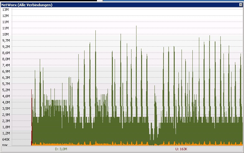

Looking at the graphs it seems to bounce a lot in terms of speed.

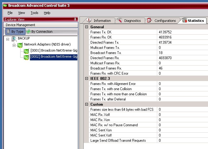

the only thing i found is NIC statistics
Also i found that this NIC shares same IRQ (16) as SAS controller
Thomas
Wed Nov 16, 2011 10:26 pm
NIC stats don't help much (except we know for sure there are no transmit errros / collisions). Also it's absolutely OK to share IRQ for PCI/PCI-X/PCIe devices. What you need to run is some TCP tests from the place you experience slow network results. NTtcp or / and IPerf. Is it possible?

what is strange, the speed varies a lot. One time it took 800mins for an 140gb snapshot and next time it took only 60mins.
And when its sort of slow i can see NIC copy speed is going up/down all the time from 10-20MB/s
Does this still sound like an IRQ issue?
With tests i am a bit limited because only ESX has access to that storage.
Fri Dec 02, 2011 12:10 pm
I would blame hardware. Can you put NIC into other slot?
ghost wrote:what is strange, the speed varies a lot. One time it took 800mins for an 140gb snapshot and next time it took only 60mins.
