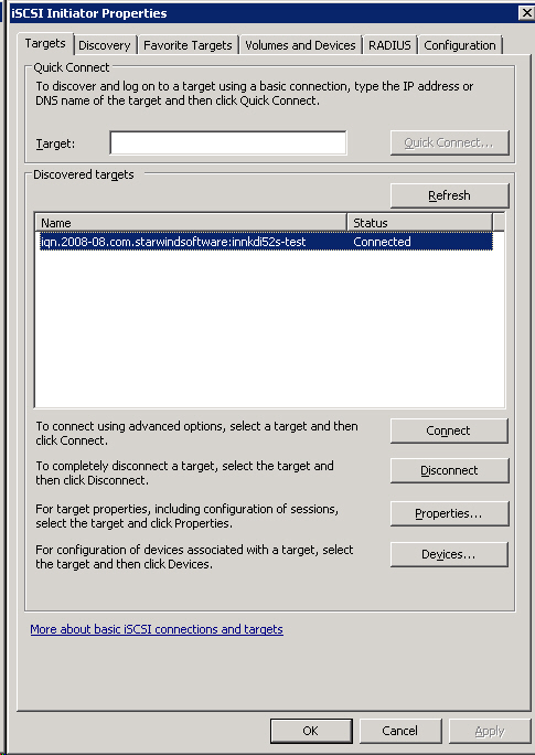

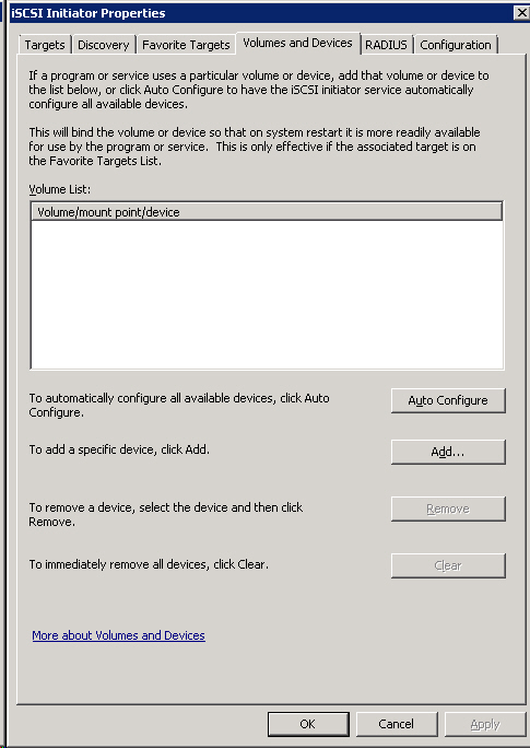

autoconfigure devices? Could you please attach screenshot?
soscvio
Posts: 9
Joined: Thu Feb 04, 2010 2:05 pm
Fri Feb 05, 2010 11:48 am
Sure

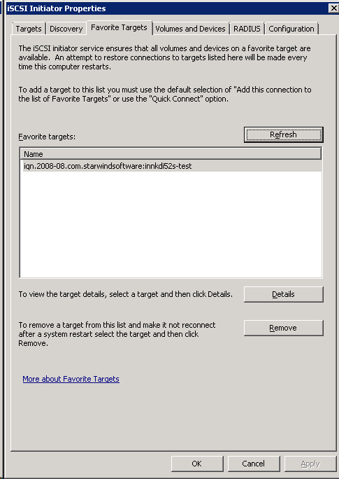

soscvio,
I don't get that problem (although I never tried to use the feature until just now). The stuff you want to autoconfigure - is it already listed on the Favourite Targets tab? That's all you need if you want to automatically connect to a target after a reboot. This autoconfigure stuff is presumably to help you if you have system/application dependencies that need the targets to be present earlier than normal (I guess it starts the iscsi client service earlier or something).

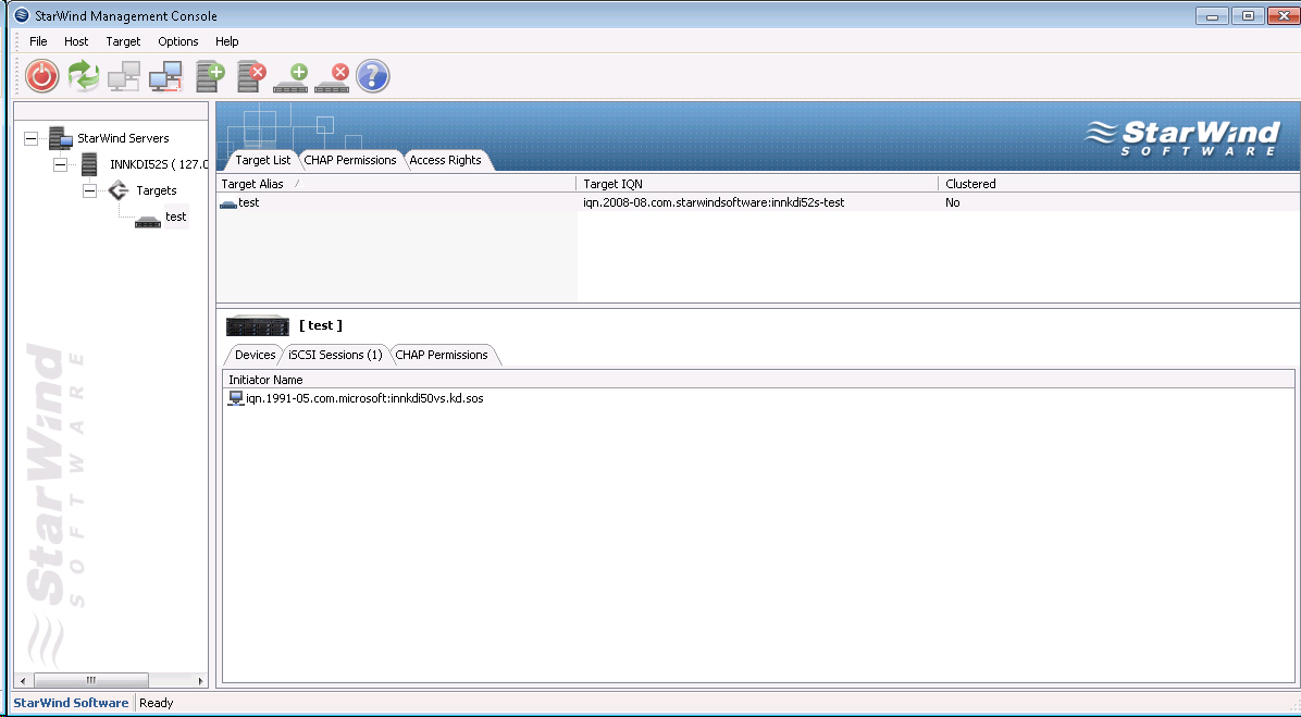

That was only an example, the disk is not seen by the client, I did a few screenshots:

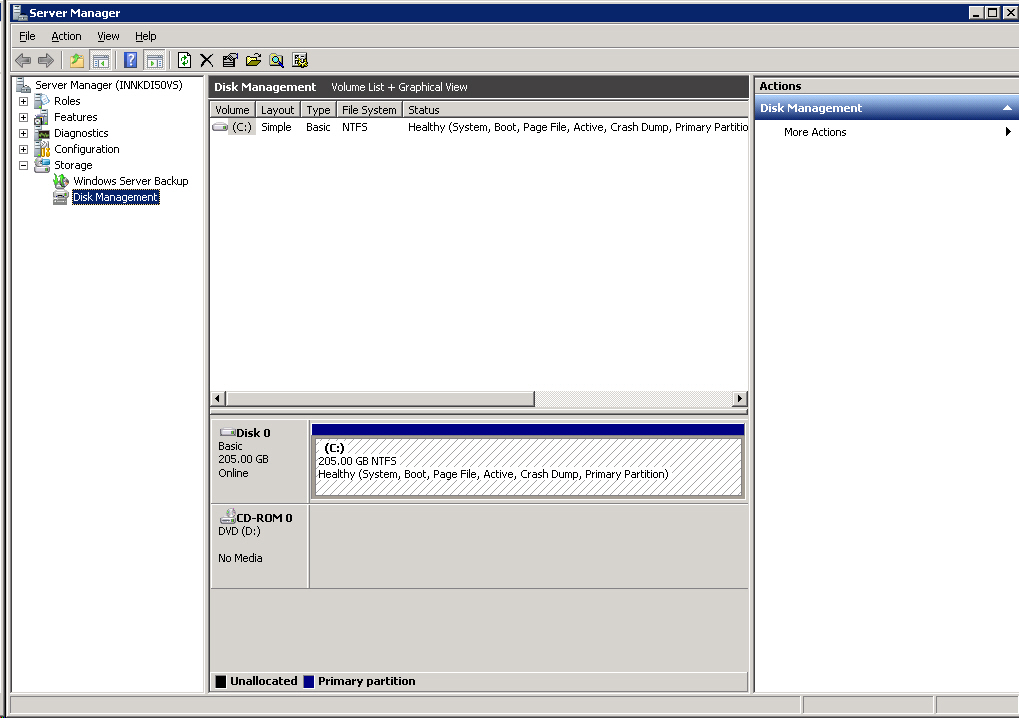

The disk managment screenshot:

OK, that's weird... and I haven't seen it before...
I think the problem is likely to be with windows disk management - as clearly the iSCSI initiator is connected to Starwind. The fact that the volume is not showing up is probably also the reason why you have nothing in "Volumes and Devices" even though you clearly have on "Favourite Targets". Have you tried listing volumes with diskpart?
I would try restarting the Virtual Disk service on the initiator machine. If that doesn't work try a reboot (although I guess you've already tried that). Failing that, see if you can connect from another machine to starwind. If you don't have anything else, you can try the MS initiator on the same server as Starwind...

we tested it from the second cluster node - and it works fine (same Hardware, same OS version).
Only from the first node, we dont see the volumes - same problem with diskpart.
