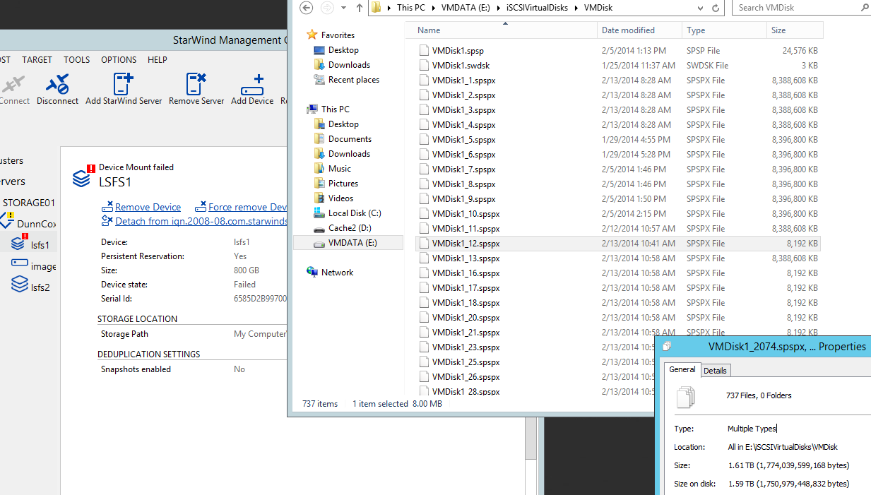

How can I try to remount a failed mount lsfs lun?
I don't see an option to try again, or do a repair on the lun to see what cause it.
After a little search, I found the problem or cause,

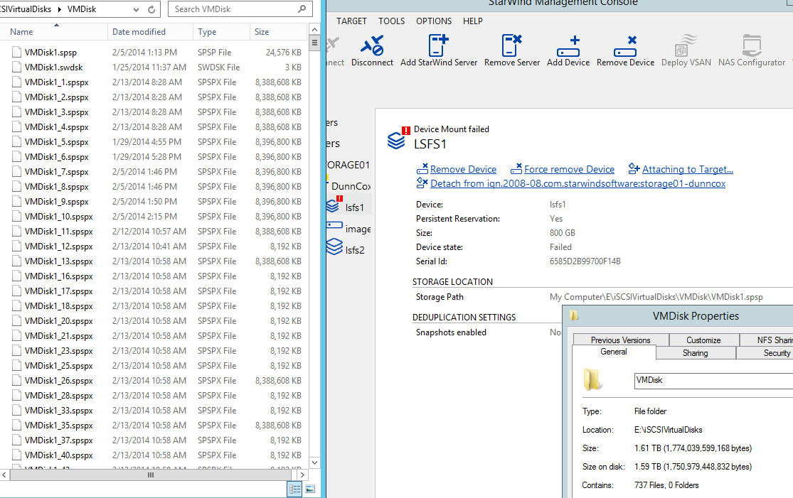

I created a 800GB LSFS LUN on my drive E: in a directory call VMDisk, then I format it from ESXI as VMFS5, the file size of that directory at that time was 80GB with about 9 .spspx files, I have then put one VM on it, this VM is using a 80GB HD. I was using the previous version of iSCSI-SAN v8.0.6345. I then installed v8.0.6383. At this time I did not check to see what the problem was, but now after restarting my SAN, and see that it still failed to mount.
I check my Drive E: to found that I was running out of disk space, ??????????????????????????, impossible I say, because I should have 2TB Free.
I did not see any new files on my E: drive until I look inside the VMDisk directory, that's the directory that has the failed LUN, anyway is has 735 .spspx files and was 1.8TB in size.
WTF, HOW, WHY, !!!!!
So I knew that it had only 9 spspx files so I deleted the others, since there is no way to do a repair or re-mount, I restarted my SAN.
All those files I deleted came right back.
How can a 800GB non-dedup LUN, use up 1.8TB of disk space?
Is there a way to recover this LUN, so that I can get access to the VM and copy it to another LUN or disk?
http://i60.tinypic.com/wj8fw7.png
http://i57.tinypic.com/124elxz.png

Please, send me StarWind logs for failed mounting attempt.
Also, what was the workload for this device?

It was a EnterpriseCA VM with Windows 2012 R2 Datacenter 4GB RAM and 80GB HD. WORKLOAD ?!?!?!?!?!
how do I send the logs?
Where to look for workload in iSCSI Manager?
hope this work, attaching logs: failed max size 256KiB, that is real FUNNY :(
ok, link to logs: https://mega.co.nz/#!945lQJJI!nf1w-CUIw ... IiPXayXSY8

How can I set the LSFS LUN to use 8K for ESXI, it seems to be fix at 4K?
I found this post from long ago:
Vitalii (staff) wrote:You may try opening the needed LSFS device as read-only, so you will be able to read all the data from it.
To do this, edit the .swdsk file of that device. It has an XML format.
find the following line:
<mode>1</mode>
and replace it with
<mode>2</mode>
then try to mount this device, it should be mounted as read-only.
I will try it to recover my VM.
I will report back.
Update:
The LSFS LUN is now load as Read-Only in iSCSI Manager.
I can now the see LUN in ESXI when adding back the LUN to esxi, but it is not seeing the file system, because esxi is asking me which format I want to use VMFS5 or VMFS3, and because it's read-only it can't format it, which is good and bad at the same time.
My objective it to recover a VM from this LUN, any help is welcome.
R&D and QA guys are checking what's wrong. I'll let you know about the results ASAP.
You should never delete any virtual disk related files manually.
