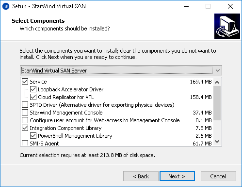

Hello verticalsoft,
Did you install Loopback Accelerator Driver during the process of StarWind installation?
verticalsoft
Posts: 14
Joined: Mon Oct 08, 2018 3:07 pm
Mon Oct 15, 2018 9:01 am
Oleg(staff) wrote:Hello verticalsoft,
Yes confirmed, I did the Server setup.
