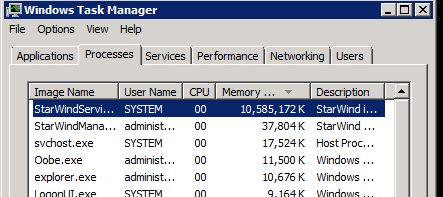

I have 3 LUN
1.6TB - lun1
1.5TB - lun2
150GB - lun3
but the starwind service is using about 4.4GB Memeory, is this normal?
Bohdan (staff)
Posts: 435
Tue Nov 12, 2013 8:48 am
Hi.
It depends on the cache settings you have specified for those LUNs :)
It is not normal in case of no caching or if the sum of specified cache size values is significantly smaller.

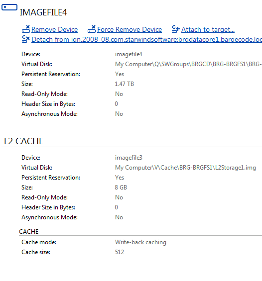

On a 2008R2 system, I experience a memory problem when L2 cache was used. Everything seemed fine until the reboot. After the reboot, Storage sizes I had assigned to L2 cache were consumed in memory after the reboot. As in 100GB drive, 128k L1 cache, and 2Gb L2 cache, on reboot 2Gb of addition memory was used from RAM. This was the same system I was having the VSS hardware driver error on, in the previous post, unfortunately we have already dismantled the system and didn't have any logs to share.

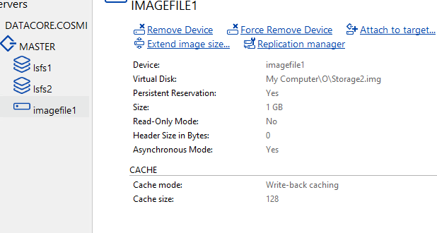

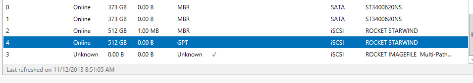

Storage Pool and Image files don’t mix, but lsfs do work?
There is no direct Feedback that the creation of an image file did not work until you review the log file. It appears incompatible with advance format drives? Or drives that are reporting 4k sector sizes as is with Storage pool disks.
I feel Storage pools will be gaining momentum in the next few years. This problem with the Image file seems related to some of the problems I experienced with LFSF files not being portable/moveable on a simulated OS failure. There will be a need to move files from physically failed raids to new raids, it seems very tedious to copy out and copy into the container files.
Check the log file at 8:15:53 is the most resent attempt to create an image file
LSFS are fine, but the 3rd one an image files shows 0 and 0.PNG (11.18 KiB) Viewed 574638 times
seems fine.PNG (17.66 KiB) Viewed 574637 times

It appears we had not yet dismantled the 2008R2 system with the Cache Problem
L2 cache 8GB.PNG (18.61 KiB) Viewed 574635 times
2008r2 Memory Usage.PNG (12.16 KiB) Viewed 574633 times
127.0.0.1-3261-service-starwind-20131112-092905.zip
