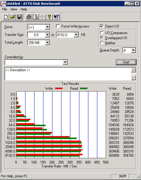

Hi all,
Finally, I SOLVED my issues.
There was a strange problem with my Cisco SGS200 switch. For some strange reason, a single-NIC ATTO benchmark was fine, but multiple load on the switch resulted in very strange and sporadic slowdowns.
Meanwhile, the intel I350 NIC works well in a 3-path MPIO setting together with one Realtek adapter. Some results attached to this. Although still far away from loopback-performance for small transfer sizes, we have a significant improvement. Maybe also due to tcp parameter tuning...
Thank you all very much.
