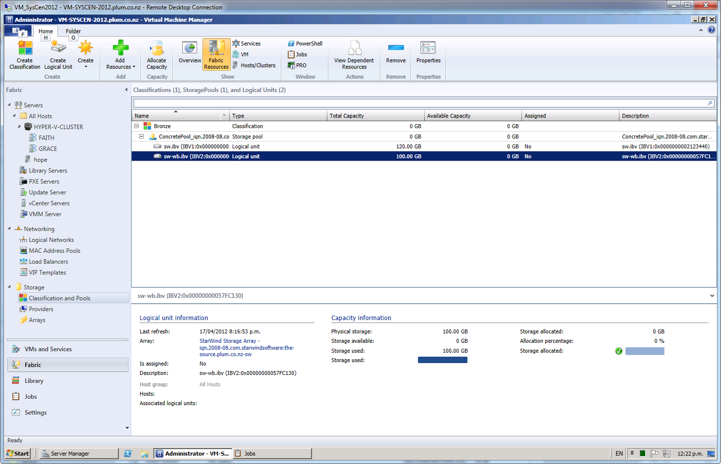

Hi Yuri,
Please see attached image that shows the issue we are seeing.
Problem with 0GB shown for classification

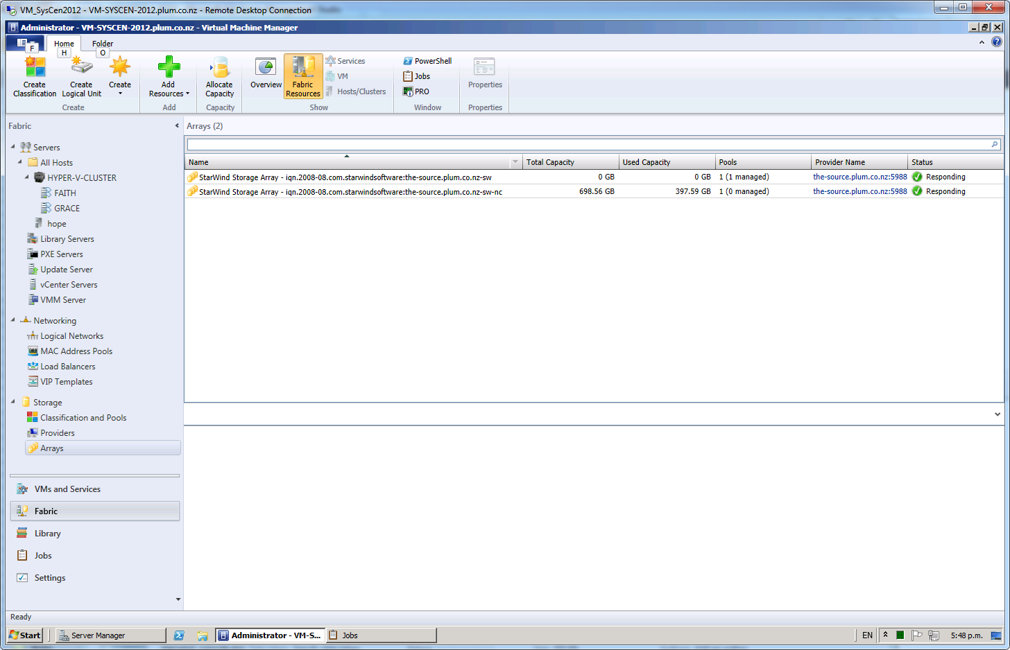

Perhaps this picture illustrates what I was talking about better:-
Here are two targets both on the same StarWind server, the top one offers a clustered target server, the bottom one designated with a -nc on the end of it's target name doesn't. The unclustered target shows available space on the StarWind server the clustered version doesn't.
