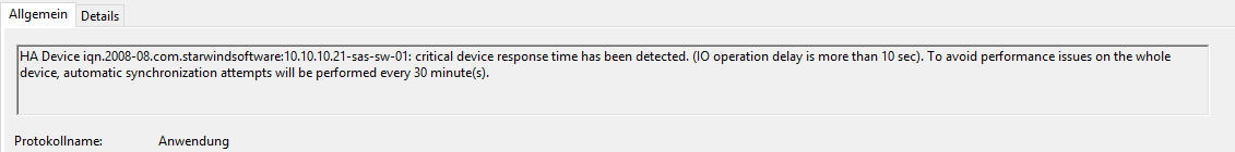

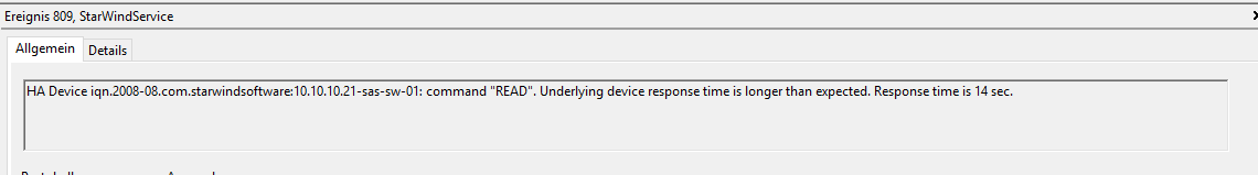

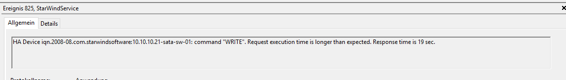

The following error messages can be found in the event logs of the first vSAN server.
Could this be another problem? Our configuration is the following:
  • Both ESXi hosts have 3 SAS Disks in Raid 5 (3x4TB) and 5 SSD Disks in Raid 5 (5x400GB)
  • Almost the full space is passed through to the vSAN Windows Machine
  • In windows the .img, .swdsk files are placed directly on these Disks
  • Both Windows Drives are NTFS
Best Regards
