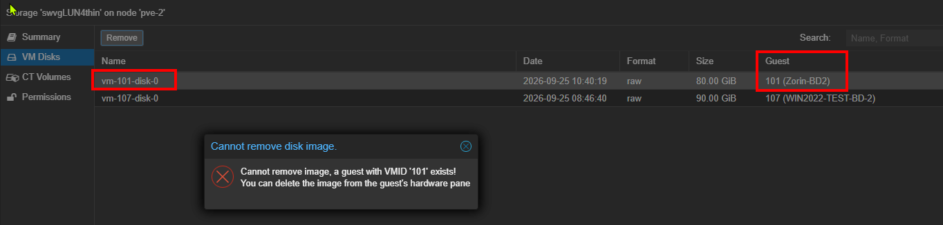

On VM ID 101, I do a "move storage" on disk and while task is still running I cancel it.
Target datastore is on a Starlvm storage.
At this stage, task is already cancelled, but HDD on target datastore are still here
Move HDD to Starlvm storage : NO OK

unsupported storage of vg 'swvgLUN4thin'
 deleting vm-101-disk-0 from swvgLUN4thin/lvmth-101
There is no "Task OK" or "Task Error" at the end of log...
And orphaned HDD can't be remove as there are linked to VM ID 101
Orphaned HDD.png (21.51 KiB) Viewed 9393 times
But no orphaned HDD on VM 101
root@pve-2:~# qm disk rescan
rescan volumes...
unsupported storage of vg 'swvgBIGBIGlun'
unsupported storage of vg 'swvglunbd'
unsupported storage of vg 'swvgBACKUP'
VM 101 add unreferenced volume 'swvgLUN4thin:vm-101-disk-0' as 'unused0' to config
VM 107 add unreferenced volume 'swlunBD:vm-107-disk-0' as 'unused0' to config
VM 107 add unreferenced volume 'swlunBD:vm-107-disk-1' as 'unused1' to config
VM 107 add unreferenced volume 'swvgLUN4thin:vm-107-disk-0' as 'unused2' to config
Then I was able to remove orphaned HDD.
But there is really a bug as moving HDD to local storage does NOT create an orphaned HDD
