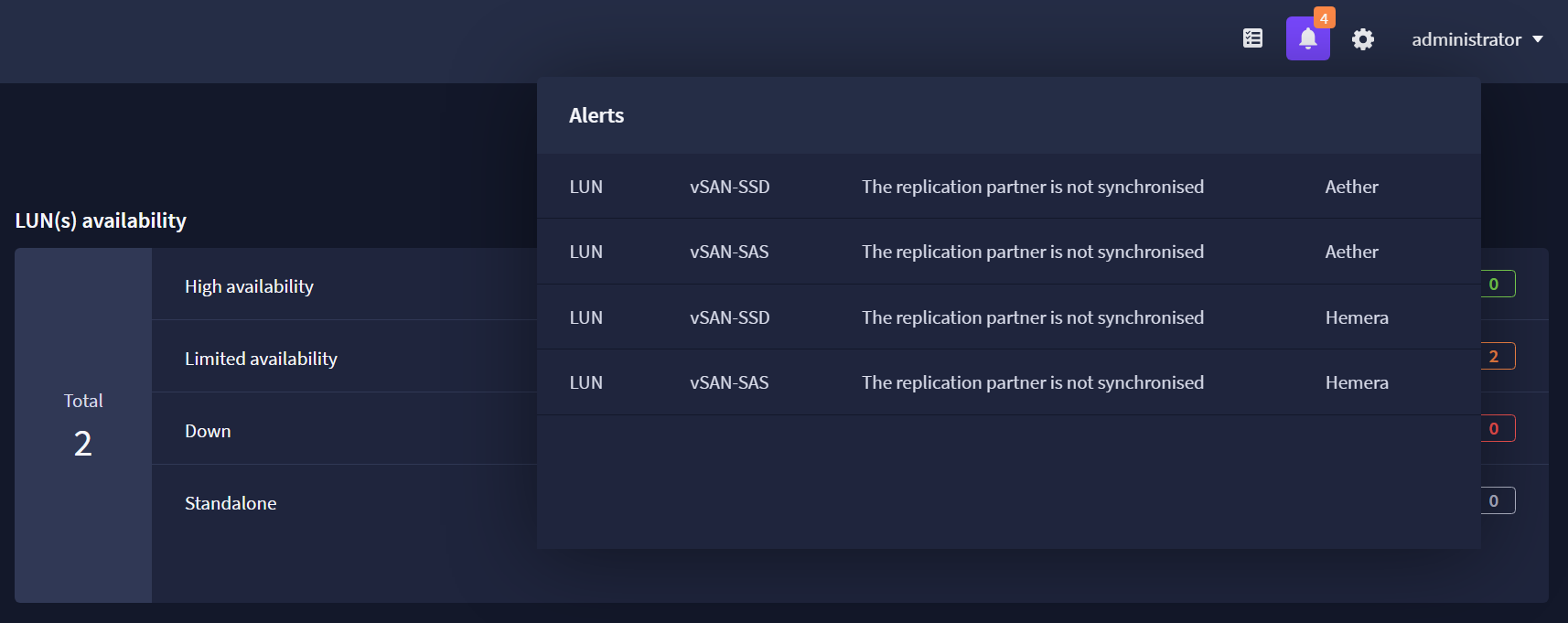

Issue: Initial full sync starts normally (~2 hrs and ~24 hrs), and completes successfully. SyncHaDevice.ps1 run on each CVM shows that both HAimage1 and HAimage2 are synchronized. The web console on each CVM however shows both LUNS with limited availability and shows alerts on each CVM that the replication partner is not synchronised.
Shutting down the the primary node causes the iSCSI storage to become unavailable, so HA is not working (so the web console status is accurate.)
Check the Windows-based console. Please also check the appliances view.

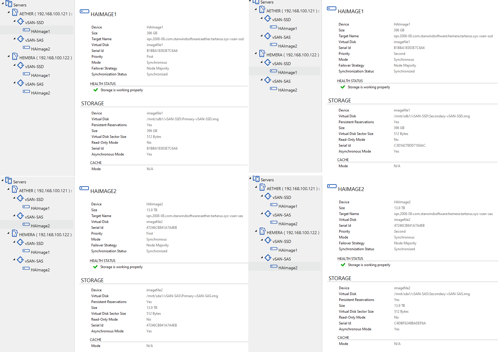

The Windows console shows that both HAImage1 and HAImage2 are up and synchronized, and both ESX servers can see and browse the files in the Datastores on the mounted LUNs.
The appliance console shows partners are not synchronized and LUNs have limited availability (so the ESX hosts are probably only seeing the LUNs on the primary CVM.
In the Windows Console view however, I can now see that:
(1) the Failover Strategy seems to be node majority and not heartbeat, and
(2) Asynchronous mode seems to be enabled.
Do these need to be changed? And if so, what PS script/option do I need to use to change them?

Glad to read it helped. Management Console, even for VSAN Free, still works to check the status and logs.
Yes, you are right, the failover strategy was not set correctly. If Network redundancy allows, use heartbeat (i.e., failover=0). Check this script out viewtopic.php?f=5&t=6852.
