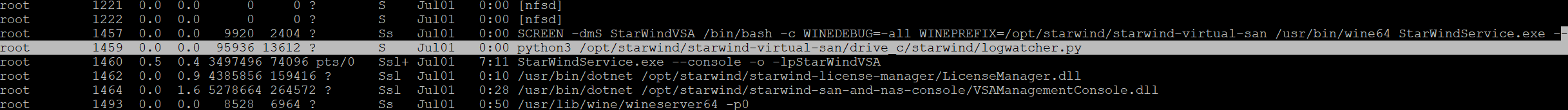

last question :)
no rescan even restart of cvm.
log watcher responsible for running hba_rescan.py and i did not filled with user pass
i did for hba_rescan.ps1. which process is responsible for that?
Screenshot 2025-07-02 103755.png (39.17 KiB) Viewed 14090 times
Re: hba_rescan.ps1 trigger
Posted: Wed Jul 02, 2025 7:48 am
by yaroslav (staff)
You need to add details to hba_rescan_conf.py. It feeds the credentials into hba_rescan.py.
I've just realized that events are also somewhat built into the script itself, so add them there as well.
