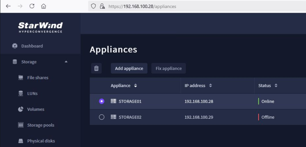

However, when I logged into one of the CVMs via the web interface, I noticed that one of the appliances in the Appliance menu was showing a status of OFFLINE.

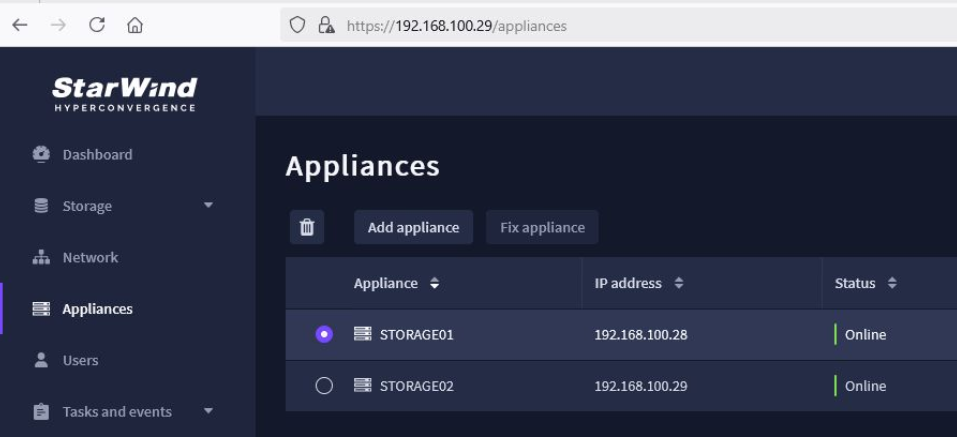

When I checked the other CVM, both appliances were showing ONLINE status.

I am sorry to say that it is a known issue, I hope it to be fixed in future builds. Try readding the node that is offline.
This can also be the time mismatch between the nodes.

Yes, the time on the nodes is correct. Could you please confirm whether removing and re-adding the instance in the production environment is safe?

You are always welcome! I never had an issue with re-adding the node (i.e., it does not affect the production).

I re-added the node and that helped — for now, everything is working correctly. It turns out that it's indeed safe to add it in the production environment.
