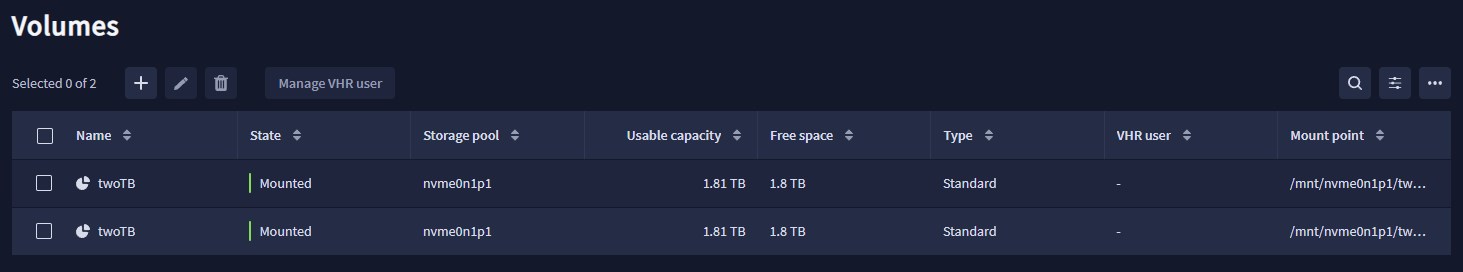

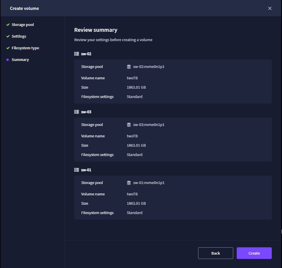

I am following the guide for 3 node setup with Proxmox. I am using the same CPU and motherboards. There is a 2TB NVMe drive in each node and passed through to the VSAN VMs. I can configure storage pools on all 3 2TB drives/nodes, but unable to create volume, it always errors on sw-02 node. There isn't any helpful to go on. I have tested the nvme drive in HD Sentinel for read/write surface test without any errors and smart attributes are fine and passes an extended smart test. So I'm trying to find out why it keeps on failing.

Welcome to StarWind Forum. Try creating a volume with the new (unique) name.

That worked. But don't I need them to have the same name? In the "Create Volume" section, it created the volume for 2 nodes with the same name, but no example for 3 nodes, but says its the same process. What am I missing? Should all three have unique names?
I continued and created the lun and now trying to get it added to Proxmox. But I'm stuck at step 6 of "Connecting StarWind HA Storage to Proxmox Hosts". It's like this section of the guide was written by a different person on a different setup! The IP addresses and host names are ambiguous and confusing. Step 8 refers to /dev/sda for I have no idea why. I don't even know how to adapt those instructions. On nodes 1 and 2, `fdisk -l` shows 3 starwind devices. On node 3, only 1. Step 13 refers to an mpatha and Step 14 refers to an mpath0 without explaining the changing of alias or if that is just a typo. (It's clear this section didn't get QA'd).

Thanks for pointing that one out. This is a known issue where the volume name is stuck in configs. We are working on it.
Nope. Names are a cosmetic thing that helps users to label their block devices. Volume names exist only in StarWind VSAN CVM, what you see in your further outputs are the LUN names.
