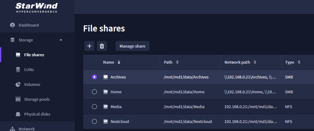

Ok I must be thoroughly confused about something. What's the attached SMB share? It's a web interface for my VSAN.
Screenshot 2025-01-23 174537.png (36.23 KiB) Viewed 82327 times

With regards to the provided screenshot, I assume the commands would be the following:
sudo chmod 0755 -R /mnt/md1/data/Archives
sudo chmod 0755 -R /mnt/md1/data/Home
