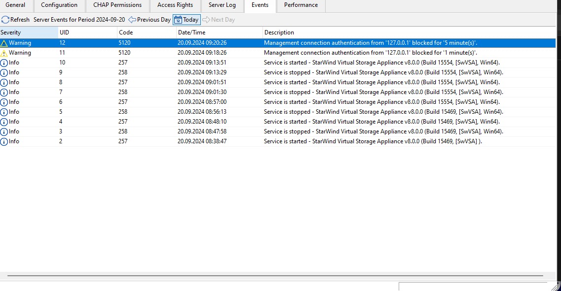

and snipet of logs
9/20 9:31:17.124507 39 Srv: TelnetListener::listenConnections: Accepted control connection from 127.0.0.1:36928.
9/20 9:31:17.143115 47 Srv: ControlConnection::processConnection: start processing 127.0.0.1:36928
9/20 9:31:17.147212 47 Srv: ControlConnection::processConnection: finish 127.0.0.1:36928
9/20 9:31:17.147240 47 Srv: ControlConnection::stop: 127.0.0.1:36928
9/20 9:32:17.144345 39 Srv: TelnetListener::listenConnections: Accepted control connection from 127.0.0.1:49512.
9/20 9:32:17.145275 48 Srv: ControlConnection::processConnection: start processing 127.0.0.1:49512
9/20 9:32:17.145595 48 func: >>> iScsiServer::sendNotification
9/20 9:32:17.145608 48 func: >>> CEventDataBase::AddRecord
9/20 9:32:17.145610 48 EventDB: CEventDataBase::AddRecord: Code 5120, severity 2, additional strings: 2
9/20 9:32:17.145627 48 func: <<< CEventDataBase::AddRecord
9/20 9:32:17.145629 48 Srv: iScsiServer::sendNotification: Send reaction start (reaction type 2, msg code 5120).
9/20 9:32:17.145643 48 Srv: iScsiServer::sendNotification: Send reaction finish.
9/20 9:32:17.145646 48 Srv: iScsiServer::sendNotification: Send reaction start (reaction type 1, msg code 5120).
9/20 9:32:17.145730 48 Srv: iScsiServer::sendNotification: Send reaction finish.
9/20 9:32:17.145734 48 func: <<< iScsiServer::sendNotification
9/20 9:32:17.145738 48 Srv: ControlConnection::doLogon: Username or password you entered is invalid.
Authentication attempts from '127.0.0.1' address are blocked for 5 minute(s).

The log is not sufficient. Can you pull the entire support bundle?
Please also reach out to support@starwind.com: Trial users still get support :) Use 1218400 and this thread as your references.
Are you concerned about blocking notifications? This is a known issue, but it never affects synchronization.
I do not see it affecting synchronization or the server either.
