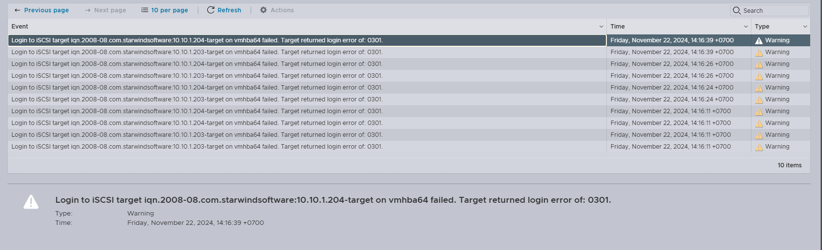

Dear Sir
According to the attached image, is the LUN creation unsuccessful? Because when I add it to esxi, it fails.
Posts: 4508
Fri Nov 22, 2024 9:35 am
You have a connectivity issue there.
Please note that your script is fundamentally different from what was shared above. Please also check if your system meets best practices (https://www.starwindsoftware.com/best-p ... practices/) and system requirements (https://www.starwindsoftware.com/system-requirements)

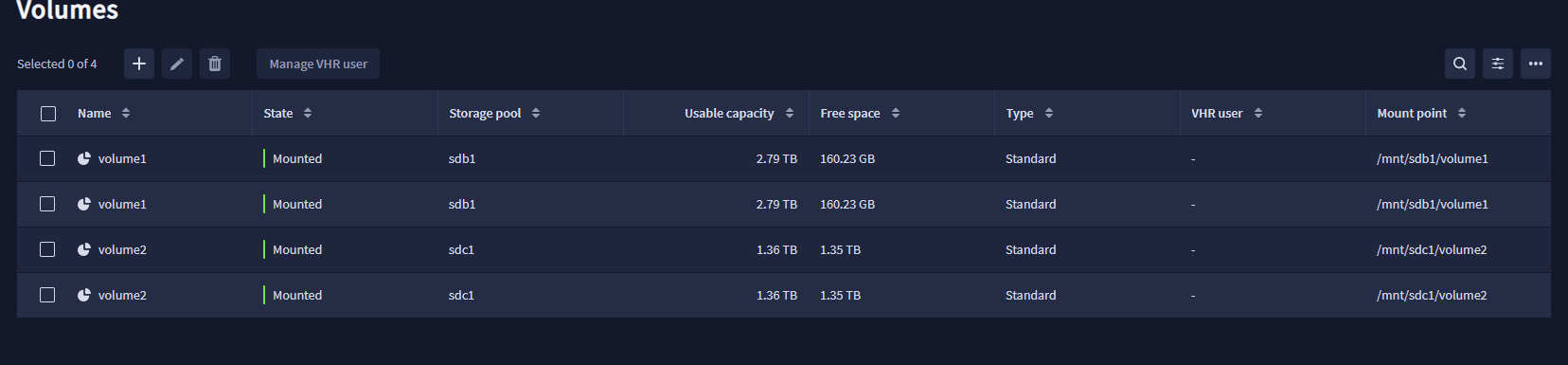

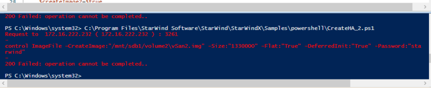

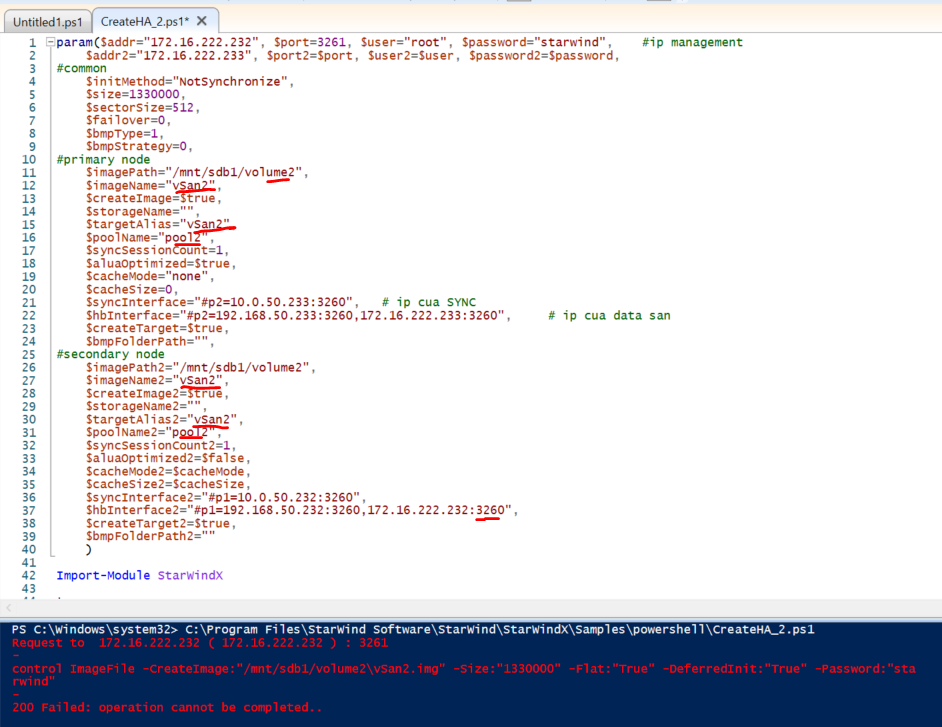

Dear Yaroslav ,
I have 2 volumes, I have created lun with volume1, but when I create lun2 with volume2, it shows an error, please fix the script to create lun2 for me.
Script:

Please help me fix the error when creating volume2 according to the attached image. The volume1 I created used "$imagePath="/mnt/sdb1/volume1", $imageName="vSan1","
Script:
param($addr="172.16.222.232", $port=3261, $user="root", $password="starwind", #ip management
$addr2="172.16.222.233", $port2=$port, $user2=$user, $password2=$password,
#common
$initMethod="NotSynchronize",
$size=1330000,
$sectorSize=512,
$failover=0,
$bmpType=1,
$bmpStrategy=0,
#primary node
$imagePath="/mnt/sdb1/volume2",
$imageName="vSan2",
$createImage=$true,
$storageName="",
$targetAlias="vSan2",
$poolName="pool2",
$syncSessionCount=1,
$aluaOptimized=$true,
$cacheMode="none",
$cacheSize=0,
$syncInterface="#p2=10.0.50.233:3260", # ip cua SYNC
$hbInterface="#p2=192.168.50.233:3260,172.16.222.233:3260", # ip cua data san
$createTarget=$true,
$bmpFolderPath="",
#secondary node
$imagePath2="/mnt/sdb1/volume2",
$imageName2="vSan2",
$createImage2=$true,
$storageName2="",
$targetAlias2="vSan2",
$poolName2="pool2",
$syncSessionCount2=1,
$aluaOptimized2=$false,
$cacheMode2=$cacheMode,
$cacheSize2=$cacheSize,
$syncInterface2="#p1=10.0.50.232:3260",
$hbInterface2="#p1=192.168.50.232:3260,172.16.222.232:3260",
$createTarget2=$true,
$bmpFolderPath2=""

$poolName2="pool2", is invalid parameter.
HINT7
Do not change poolName.
Make sure you remove the leftover files in /headers on both nodes and underlying storage.
Please look through the guide. Take my script. Do NOT change any other parameter than path, sector size, or IPs. If you would like to modify any parameter, see the HINTs.
