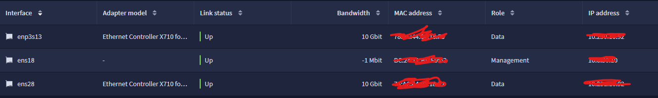

I set everything up, just fine, assigns the interfaces its' roles, and everything is working. Until i reboot the appliance.
After reboot, one of the passthrough iscsi NICs is suddenly becoming the management interface, and the only way to access the webgui is to hook up a vm to the iscsi vlan and access the webgui on its iscsi IP and correct the role assignments from there.

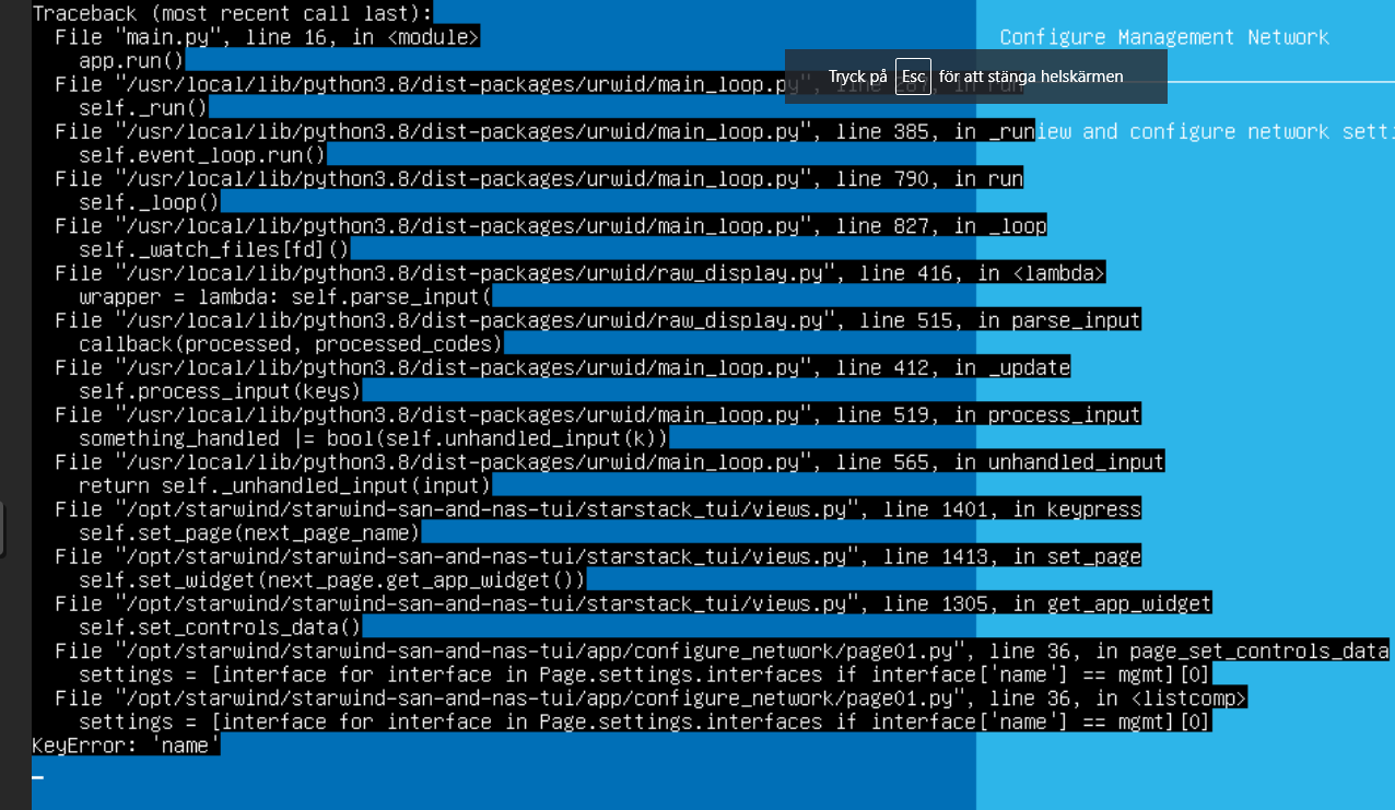

When I add two more virtualized adapters, there is only a blank screen on the webgui telling me: "Management service is starting. Please wait..." after starting up.
Attached screenshot is what appears when i go into the console and try to set the management network manually.
