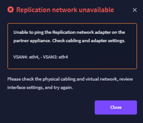

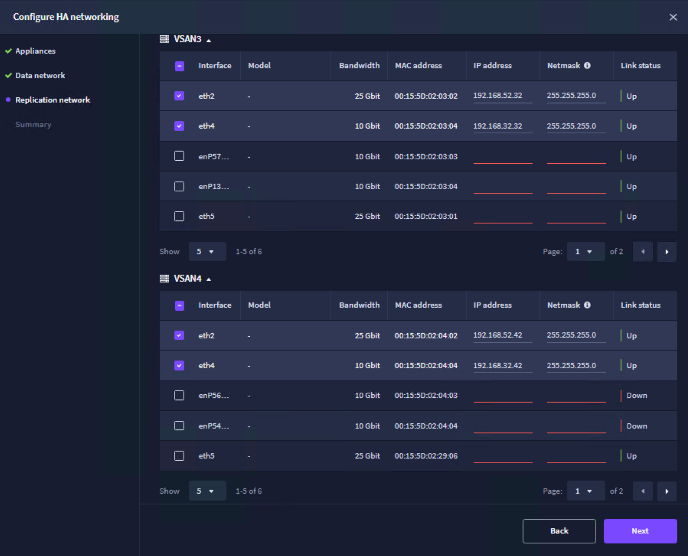

I am trying to setup a 2 node hyper-v using the linux CVM guest VM's following this article:
https://www.starwindsoftware.com/resour ... ng-web-ui/
I have 2 NIC's directly connected to each other, as well as 2 NIC's connected through a switch. Both of them give me this error when running through the "Configure HA networking" wizard. From the console of both CVM's, I can ping all the interfaces of each host between each other, i'm not sure what's wrong with the config resulting in the error saying it can't ping...

Do you have sriov on them?

Yes, I enabled sr-iov. I installed some Mellanox connectx-5 dual 25Gb cards. As well as updated the firmware and enabled sr-iov on the 10gig daughter card.

I think that is the problem.
What NIC do you use?
Please make sure to install te drivers into the CVM.

I thought I ubunto included the drivers with the kernal? I ran sudo apt update and sudo apt upgradr and it made no difference. I can ping from the VM shell all the interfaces. Is there a linux command I need to do to enable sr-iov directly in the CVM?
