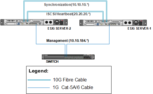

I have made setup for 2 Node Starwind vSPhere configuration.
Setup ESXi Server1 & 2:
Management (VM) Port Connected to 1G Copper Switch.
ISCSI/Heartbeat and Synchronization is connected directly back to back at 10G-SFP Ports of servers using fiber cables.
StarwindVSA (preconfigured VM) is deployed in both ESXi Server.
I'm trying with Starwind Free version. Im using powershell comands for configuring.
During creation of HA configuration it is throwing an error in both servers.
Error in ESXi Server1 - HA: HAPartneriScsiChannel::permanentConnectionPollingThread: Waiting 6 sec before retry sending backward connection command ...
Error in ESXi Server2 - HA: *** HAPartnerISCSIChannelManager::sendCustomControlScsiCommand: EXITing with failure(failed), valid channel is not found!
I have attached the Code and Logs.

Kindly Help me out.
Kishore CA
Fri Feb 10, 2023 11:36 am
The sync IP address is wrong: you are using 10.10.10.200 for both servers.
Kishore CA
Posts: 26
Joined: Wed Jan 04, 2023 10:38 am
Mon Feb 13, 2023 4:32 am
yaroslav (staff) wrote:The sync IP address is wrong: you are using 10.10.10.200 for both servers.
Thanks for that sir.
But even after correcting this synchronisation is not happening. When i check the network speed in starwindvsa VM web browser it is showing data transfer in kbps speed.
I have connected 10G ports back to back, should i want to use any switch in between??.
any other things should i want to check??
Kindly help.
Mon Feb 13, 2023 5:07 am
Were you able to ping the servers via that link?
Try setting MTU to 1500 for the entire network stack (vSwitches and inside the VMs).
Kishore CA
Posts: 26
Mon Feb 13, 2023 7:42 am
yaroslav (staff) wrote:Were you able to ping the servers via that link?
I’m able to ping sir .. yes I have tried with MTU 1500 also..
But even then it’s same problem.
Mon Feb 13, 2023 1:26 pm
Can I have the logs, and the new script, please?
Kishore CA
Posts: 26
Tue Feb 14, 2023 10:08 am
yaroslav (staff) wrote:Can I have the logs, and the new script, please?
Latest Code and Logs are attached. Kindly highlight my mistake sir.

This is the code I’m using sir.
Can u please highlight my mistake in the script.
Mon Feb 27, 2023 11:24 am
1) cacheMode not selected.
2) poolName, leave it unchecked.
4) Bitmap folder not selected.
3) For simplicity, use the previous build.
