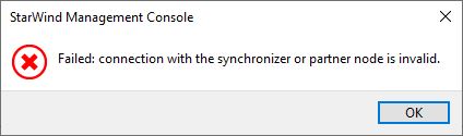

> At Replication stage I'm getting n error saying "200 Failed: Synchronization Failed" "Couldn't send the command to partner node".
Kindly help me out.

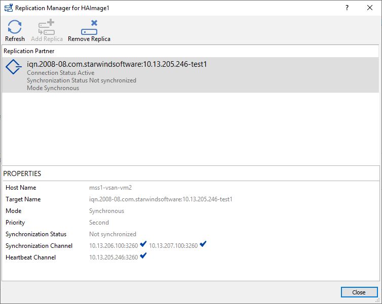

After changing to MTU 9000 in switch it has worked but later finding issue in synchronization.
I have uploaded the logs kindly check and help me out.
VM2_Sync Command.JPG (17.42 KiB) Viewed 27667 times
Tue Jan 17, 2023 12:05 pm
Changing MTU brings down the network interface. Please make also sure to align the MTU value on the entire network stack.
Please restart StarWindService on the not synchronized node.
Also, make sure network redundancy requirements are met https://www.starwindsoftware.com/system-requirements. If there are no direct links in your system, make sure to have redundant switches or consider plugging synchronization directly.
Please also avoid traffic mixing on physical interfaces (i.e., use dedicated links for iSCSI and Synchronization). See more at https://www.starwindsoftware.com/best-p ... practices/
