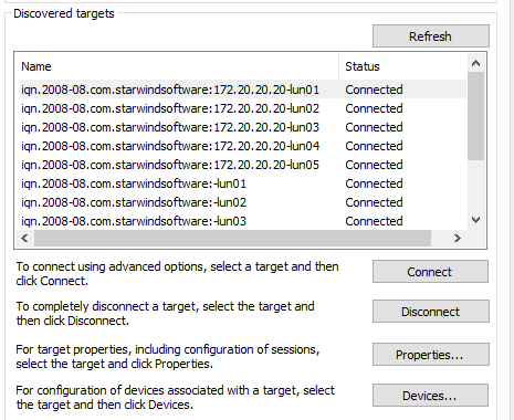

To disconnect iSCSI clients, is this procedure as simple as loading up the iSCSI Initiator and disconnecting all Discovered Targets?

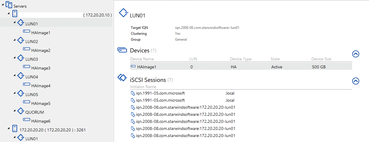

Attached is another picture from the console of Node 1 LUN01
All HAImages are displaying Synchronized and Health Status is Green

As this is my first time doing a version upgrade I would just like to clarify the procedure for “To prevent data loss, disconnect iSCSI clients from StarWind nodes”
Please note that the whole sentence says, "To prevent data loss, disconnect iSCSI clients from StarWind nodes – for builds, where it is specified as a requirement in StarWind Release Notes;"
No need to disconnect iSCSI sessions, therefore; stopping StarWindService before the update should do it.
