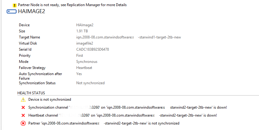

I have a cluster in starwind virtual san free.
One server ( node) is in service center, and i have one left one server ( node).
Happened hard power off on the server, and all disks located in the condition "Not Synchronization" and dont presented to ESXi.
Tell me please how by using power shell scripts did device“Mark as Synchronized”.

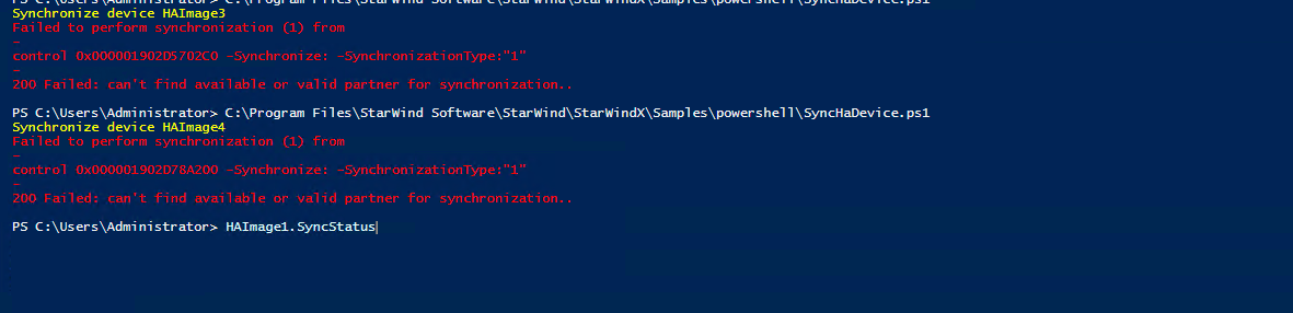

i have one node in HA cluster.
Run script "SyncHADevice" issue error
Failed to perform synchronization (1) from
control 0x000001902D570A00 -Synchronize: -SynchronizationType:"1"
200 Failed: can't find available or valid partner for synchronization..
I need recovery iscsi connect to esxi.

Alex
Posts: 12
Joined: Sun Oct 02, 2022 2:28 pm
Mon Oct 03, 2022 3:54 pm
Currently there is no second server.

Alex
Posts: 12
Tue Oct 04, 2022 7:44 am
Here is the information in the console
Not available for ESXi
