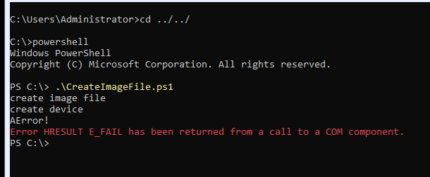

when i try to create my first device, after created the image
I got this error:
Error HRESULT E_FAIL has been returned from a call to a COM component.

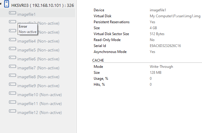

I can see many devices been created in the console. In the event log, i can see the device been created too, I can create target based on the device name. However, when I run enumDevice scripts from powershell sample, only target showed up.
It appears to me that powershell library is broken for device related functions. I cant enum/remove device from powershell. Any idea how to fix?
My code for creating image/device/target( I ran them one by one to debug):

Thanks, I was using the sample PS scripts ( just added in my post). I ran the code for create image/create device/associate target by commenting out the rest.
There was no error for create image and associate target, the error appears for create device, but it seems the device was created anyway.
And enumDevice doesnt work (using the sample scripts)
