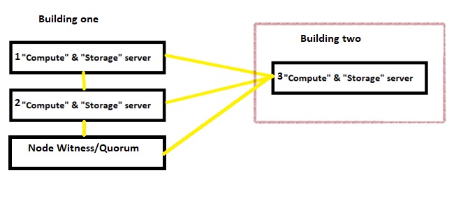

It is scenario 5 that I am most hesitant with starwind. My new proposal is for either S2D or Starwind to operate with 3 nodes. Two nodes in the Primary site and one in the secondary. From my research, S2D can be configured exactly the same way as hyper-v cluster: I can add votes to the primary site nodes (+ quorum) and take a vote away from the secondary node. I have not tested this as I am at the planning stage. I would like to see if starwind can be set as similar. This is my PROPOSED setup:
Scenario 6 - starwind+compute nodes 1 and 2 live in primary site and have visibility of a quorum NAS. Secondary site has starwind+compute node 3. Network visibility between primary and secondary site is lost - this could be due to power loss, someone cutting through my fibre, fire in primary site. I know already that I can set my cluster to have "no votes" therefore the cluster will need to be brought up manually, however I dont know if the starwind node 3 can be brought online for the hyperconverged cluster on node 3 to be used or does starwind node 3 list itself as degraded. Once visibility of nodes 1 & 2 (plus the quorum) come back up, how do I let starwind know that node 3 has been authoritive whilst nodes 1,2 + quorum have been "down"? I dont want starwind 1,2+quorum deciding that "they" are authoritive whilst node 3 has been running the cluster+storage during the failure.

There is no internet in secondary site so a cloud quorum cannot be used. Since scenario 5 deals with a network failure between the two sites there would be no "middle denominator" visible to both sites. Power is independent to both sites and they are situated 100m apart physically. I have experienced all 5 of these scenarios with both testing and in practice
then I would like to use node3 as the cluster storage (and bring up the cluster manually on node3).
This is why I suggest using a node in a different location.
Do you mean a 3-way mirror?
Do you mean a 3-way Mirror? If so, it provides 3x storage nodes that carry the same set of data. You cannot set a 3-way mirror with node majority and a witness though.
3 node HA pointless as it appears starwind will not operate with 2 HA nodes out of 3 HA nodes failed
It is not pointless. It just does not fit the scenario of the stretched cluster without fine-tuning. The heartbeat failover strategy allows for having 2 nodes down while a 3-way replica with node majority and no witness still does not.
I believe that there is a slight misunderstanding of the fundamentals of node majority here. The witness is to help to decide which site is to stay online and which is to go down. So, it should be independent of 2 sites to act properly as we cannot create 2 witness devices.

From what I can see now, Starwind will perform a 3 way mirror but cannot survive 2 node failure unless a 4th witness (non storage) node is used. All 3 storage + 4th witness nodes must be in communication with each other for this to take effect.
Starwind will partially support failed communication/partitioned network failover . I.e. for a 3 way node with 4th witness: If a network partition occurs whereby nodes 1,2 + witness are partitioned from node 3, node 3 will be marked as out of sync - the data living on node 3 cannot be used under any circumstances
for a 3 way node with 4th witness: If a network partition occurs whereby nodes 1,2 + witness completely fail and node 3 continues, node 3 will be marked as out of sync - the data living on node 3 cannot be used under any circumstances - the data is lost.
Microsoft work differently with their HA nodes and can operate with 1 node remaining out of 3 nodes + quorum even if the quorum has died this is MS active-passive model of a stretch cluster. The remaining passive node must be activated manually but the data is not lost. When resuming from this scenario, the remaining nodes+quorum accept that the single 3rd node is authority and resync back. After resync the 3rd node can be demoted again to passive. I see that starwind cannot operate in this fashion so my answer is given.
The only way I can see a 3 way node + witness working as HA is to have an infallible witness which (by design) can only happen with a cloud witness in a regular disaster mitigation plan of separate buildings. Take this diagram:
node 1 + 3 could fail, node 1+2 could fail - both of these are good as the remaining node(s) + witness will keep the data up. However, witness + node 1 + 2 (i.e. a fire destroys building one) means the data on node 3 is useless. Starwind would not suit me as the solution cannot be made to work without me finding a way to have a resilient cloud connection in both buildings as a witness, and not just a witness but a full computational node witness.

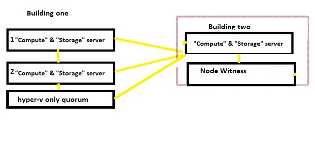

If I move the witness to building two then I risk split brain if I lose the interconnect (which has happened when a truck drove through the link once). In this scenario, if the building interlink drops there is enough quorum on both sides to operate. We have nodes 1 + 2 on one side and node 3 + witness on the other. However I COULD survive a fire in building ONE.
Ironically in this scenario I would be relying on the fact that my hyper-v cluster WOULD NOT start on node 3 in this scenario since node 3 is passive. However once the link is resumed I have no idea what starwind will do as nodes1 and 2 will have been running in mirror and node 3 starwind will have been running (albeit with no data change since there would have been no cluster running on node 3 as I would not have manually started the cluster on 3)
Witness helps to form the majority. It puts the storage in the situation of "all or nothing": the storage is not available or not. It should not cause a split-brain with Node Majority.
