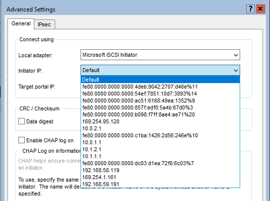

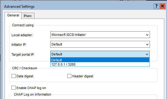

On "good" nodes, when I add connection, I have a list of ip addresses:
and on "poor" node only 127.0.0.1
What should I do?

Please provide me with a screenshot of the discovery tab. This can be an MS iSCSI Initiator GUI glitch.

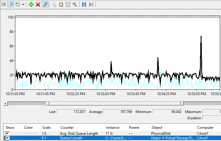

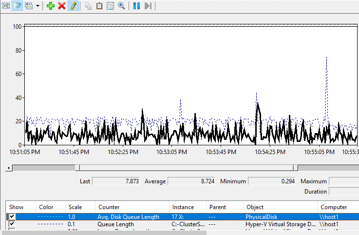

Below are results for disk queue inside vm and underlying storage
As you can see, the disk queue inside of vm is about 197 and at the same time, disk queue for underlying storage is about 9. So, I think that StarWind is a bottleneck.

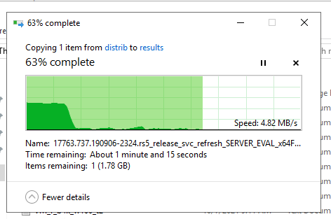

When I try to copy a file inside of my VM I get following results:
If I use 127.0.0.1 address the results are more pretty and average throughput is about 150 MB/s
