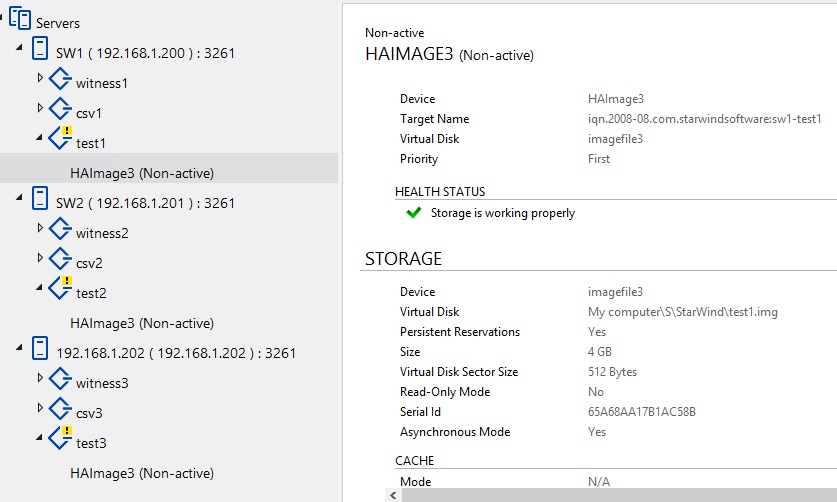

Thank you a lot for your links, I've read it, but I think it's different situation.
I don't have any nodes in not sync state.
At this time, my nodes in following state:

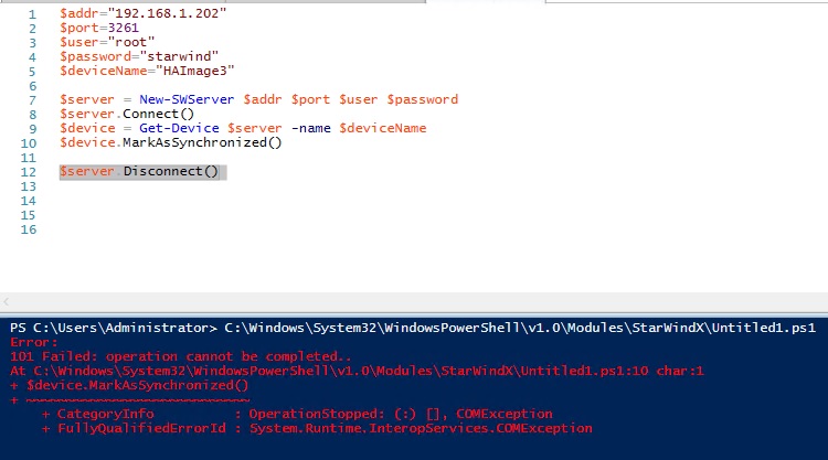

When I try to mark one as a synchronized, I have following error:

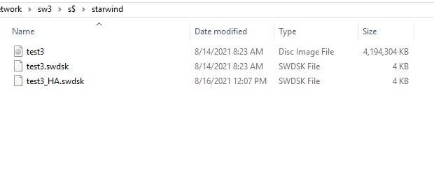

Thu Aug 19, 2021 2:18 pm
Are img files, .swdsk, and HA.swdsk files for this device is S:\StarWind?
jdeshin
Posts: 63
Joined: Tue Sep 08, 2020 11:34 am
Thu Aug 19, 2021 2:19 pm
Yes, of course

Thu Aug 19, 2021 6:13 pm
Hi Yaroslav!
Disks marked as read-only were the source of the problem. Therefore StarWind could not write to them and marked HA in an inactive state.
After I cleared the read-only attribute on the drives hosting the HA image and restarted the StarWind service, everything worked as expected.
