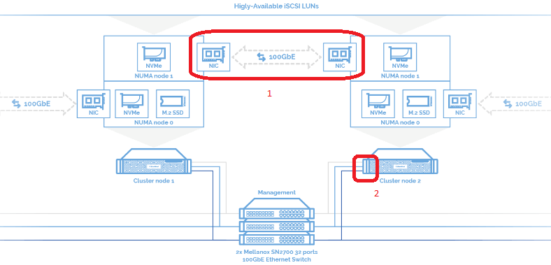

The interconnection sheet:
How many ports do you use for sync?
Is sync NIC port(s) (1 on the sheet above) connected directly (as shown on picture below) or through a switch?

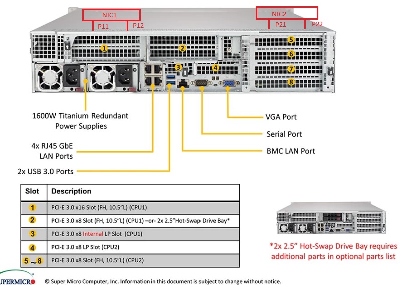

According your description, we should place one NIC per CPU as shown on figure below:
How should I connect P11-P22?
Can you please give me more explanation?

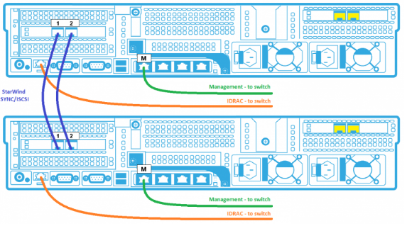

Thank you for your question. Each part of the study showcases the interconnections at the very beginning. And, yes, iSCSI and sync are going through switches.
GRID architecture implies having 2x Syncs and 2x iSCSI connections https://www.starwindsoftware.com/resour ... hitecture/. If you build a large cluster, you cannot provide enough ports for direct connections, that is why we used 2 syncs and 2 iSCSI.
The 2nd interconnect screenshot you have shared here is related to HCA interconnects which is a 2-node configuration with 1 SYNC and 1 iSCSI. That is the bare minimum configuration. There, we recommend direct connections over switched do ensure maximum redundancy.
The standard 2-node configuration is a "building block" of a GRID setup.

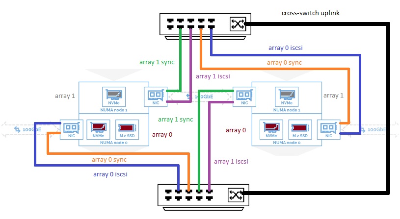

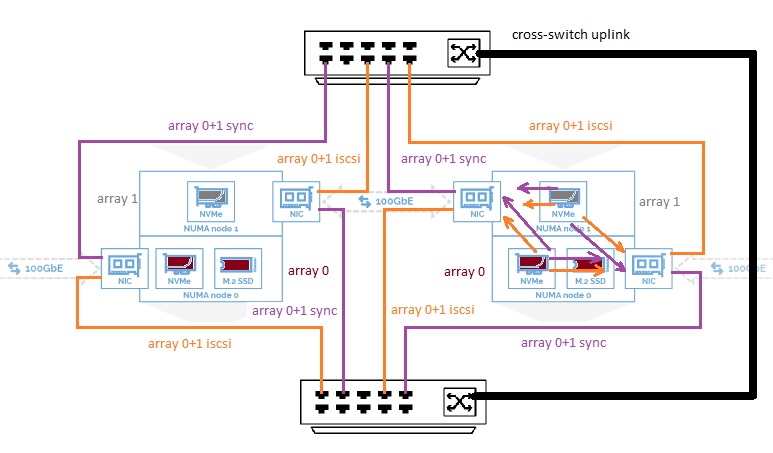

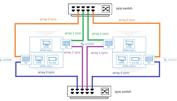

I suppose that we have two possible variants for interconnection (please, see pictures below):
and
In first case, we do not have cross-NUMA traffic, but if a switch goes off (may be for reboot) then full sync required after the switch goes on again. So, as I understand, this sheet can be used only for simple (two way) mirror.
In second case, we have full redundancy, but cross-NUMA traffic too.

Re: Current HCI industry highest performance: 26M IOPS questions
Posted: Sat Jul 24, 2021 9:20 am
by yaroslav (staff)
Oops looks like I missed that :/ My sincere appologies.
Yes, they go to different switches.
Posted: Sat Jul 24, 2021 9:39 am
by jdeshin
Like on picture below?
Yury
Posted: Sat Jul 24, 2021 10:22 am
by yaroslav (staff)
Yes, I believe.
