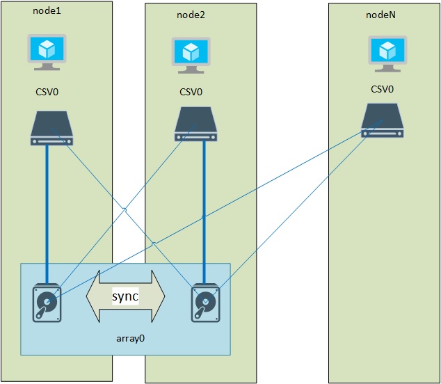

Dear Yaroslav, please, check that I understand correctly:
In normal case we have following situation:
node1 and node2 have local connections (127.0.0.1) and partner iscsi connection.
nodeN does not host array, therefore it connected only by iscsi.
When sync switch goes down, StarWind assigned one node as "main" and disable iscsi target on not "main" node.

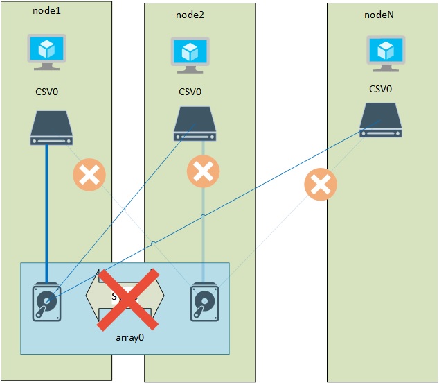

So, we have following result:
After the sync switch goes on, we will need to resync volume from "main" node.

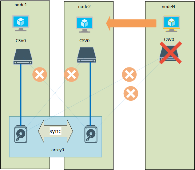

When iscsi switch goes down, we will lost any iscsi communications, except local connections on nodes node1 and node2. The CSV on the nodeN goes unavailable and WSFC have to move VM to node, that have local link with the storage.
Is it correct?

You need to have redundant switches for iSCSI. If a switch fails, another takes over.
In small deployments, where you have a point-to-point connection for Sync, you can use Sync for cluster-only communication. As I mentioned earlier, that should prevent cluster a split-brain. Alternatively, please connect Sync ports to both redundant switches, use the same subnet for them, probably, and set that cluster network for cluster-only communication.
