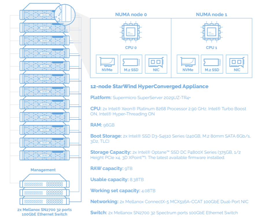

I read your paper https://www.starwindsoftware.com/hyperc ... high-score and have few questions:
Part of your hardware specification:
Platform: Supermicro SuperServer 2029UZ-TR4+
Networking: 2x Mellanox ConnectX-5 MCX516A-CCAT 100GbE Dual-Port NIC
Switch: 2x Mellanox SN2700 32 Spectrum ports 100GbE Ethernet Switch

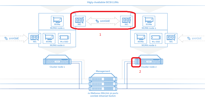

The interconnection sheet:
How many ports do you use for sync?
Is sync NIC port(s) (1 on the sheet above) connected directly (as shown on picture below) or through a switch?

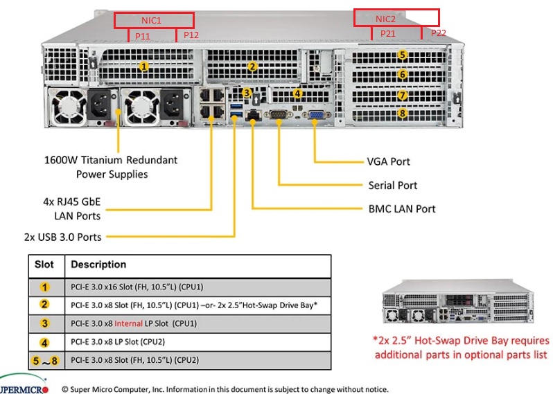

According your description, we should place one NIC per CPU as shown on figure below:
How should I connect P11-P22?
Can you please give me more explanation?

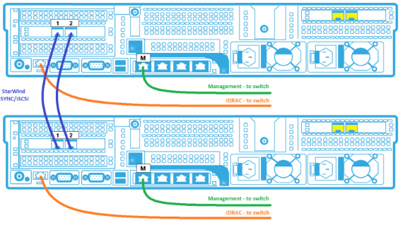

Thank you for your question. Each part of the study showcases the interconnections at the very beginning. And, yes, iSCSI and sync are going through switches.
GRID architecture implies having 2x Syncs and 2x iSCSI connections https://www.starwindsoftware.com/resour ... hitecture/. If you build a large cluster, you cannot provide enough ports for direct connections, that is why we used 2 syncs and 2 iSCSI.
The 2nd interconnect screenshot you have shared here is related to HCA interconnects which is a 2-node configuration with 1 SYNC and 1 iSCSI. That is the bare minimum configuration. There, we recommend direct connections over switched do ensure maximum redundancy.
The standard 2-node configuration is a "building block" of a GRID setup.

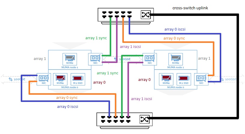

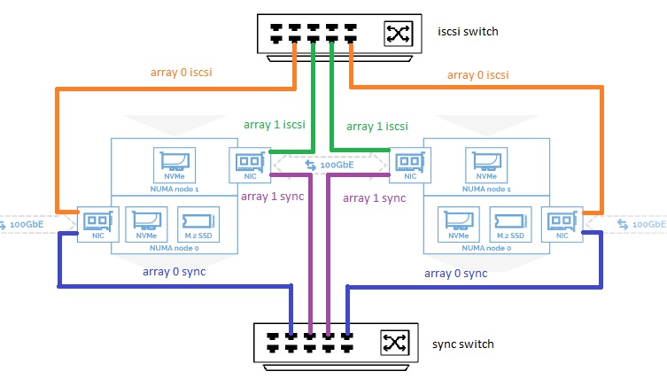

I suppose that we have two possible variants for interconnection (please, see pictures below):
and
In first case, we do not have cross-NUMA traffic, but if a switch goes off (may be for reboot) then full sync required after the switch goes on again. So, as I understand, this sheet can be used only for simple (two way) mirror.
In second case, we have full redundancy, but cross-NUMA traffic too.
What is the right sheet?

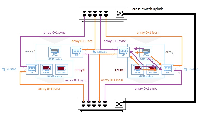

So, on your picture we have two switches and two dual port card.
Can you please, answer me for few questions:
1. Is the NIC on specified NUMA node (for example NUMA node 0) being used for sync and iscsi (for example port 1 for sync and port 2 for iscsi)?
2. Is the NIC on specified NUMA node connected to different switches?
Yury
Posts: 4510
Sat Jul 24, 2021 8:45 am
On every server, each NUMA node has 1x Intel® SSD D3-S4510, 1x Intel® Optane™ SSD DC P4800X Series and 1x Mellanox ConnectX-5 100GbE Dual-Port NIC. Each NIC carries a set of iSCSI and Sync.
jdeshin
Posts: 63
Joined: Tue Sep 08, 2020 11:34 am
Sat Jul 24, 2021 8:51 am
OK, each NIC using for sync and iscsi (one port for sync and one for iscsi).
what about second question?
Yury
Posts: 4510
Sat Jul 24, 2021 9:20 am
Oops looks like I missed that :/ My sincere appologies.
Yes, they go to different switches.
jdeshin
Posts: 63
Sat Jul 24, 2021 9:39 am
Like on picture below?
Yury
Posts: 4510
Sat Jul 24, 2021 10:22 am
Yes, I believe.

Dear Yaroslav,
Additionally, I don't understand following thing:
You use dual port 100 Gbit NICs and 100 Gbit switches, the server that you use support only one PCIe 3.0 x16 slot and other slots are PCIe 3.0 x8.
The throughput of x16 slot is 128 Gbit/s, but we have dual-port NIC, therefore we can 100 Gbit/s on NIC port only in half duplex.
Other ports can give us only 64 Gbit/s throughput.
For which do you use 100 Gbit NICs?
Yury
Posts: 4510
Sat Jul 24, 2021 11:31 am
There are 3 switches in each diagram. If one or even 2 100 GBE switches go down, there is still one Management-heartbeat switch that helps to avoid StarWind VSAN and Cluster split-brain.
Regarding your question about adapters. We used 100 GBE NICs to avoid networking being a bottleneck. We also do not recommend teaming for iSCSI and Sync so 100 GBE adapters were the only option.
I think, you will get bottleneck in your PCIe lanes, so you cannot get 100 Gbit/s throughput.
I suspect, it's not that simple :)
Could you please consult with people, who made this test?
Yury
Posts: 4510
Sat Jul 24, 2021 12:48 pm
But it is not a solution, because the cluster will goes down when one of the switches goes down :(.
We set up redundant cluster communication links in each of our deploys. One link, e.g, Management, is for cluster communication and clients. Another one, Sync, is for Cluster-only communication. So, cluster split-brain is not likely to happen.
Sure, will chat with them on this.
